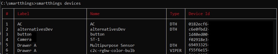

Do you mean if you need other software to use the CLI?
It can depend on the OS you’re using because you might need to install some dependencies, but you can do it using NPM and for that you have to install NodeJS. (Here’s a guide you can follow to do so)
Generally, you just need to make sure of having:
  • The CLI’s last release (you need to access to this file from the terminal, go to its directory when you want to execute commands like smartthings ...
  • The config.yaml file with your Personal Access Token
If you run a simple command like the one below and the result is the list of devices you have registered in your account, then, it’s working correctly:
smartthings devices
I appreciate the reply, Nayelyz. It’s been a while since I have worked with command lines, other than telnet, device configuration etc…
Yes, and It’s Windows 10. I did download Node.JS and attempted to perform those steps, however I’m starting to believe there may be a corrupt installation.
So, I think I will attempt to uninstall and reinstall Node.JS. and have another look at the link you provided.

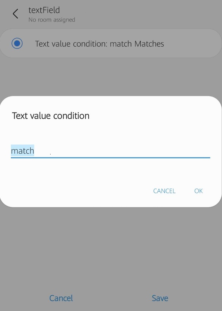

In the Automations View only the display types ā€œsliderā€, ā€œlistā€, ā€œnumberFieldā€ and ā€œtextFieldā€ are supported for the condition section.
As I understand, you have a capability that uses the state display type in Detail View and you don’t have a determined list of values, is this correct?
If so, you can use the textField display type in the Automations View, so you can type the value you want the condition to match. Here’s an example:

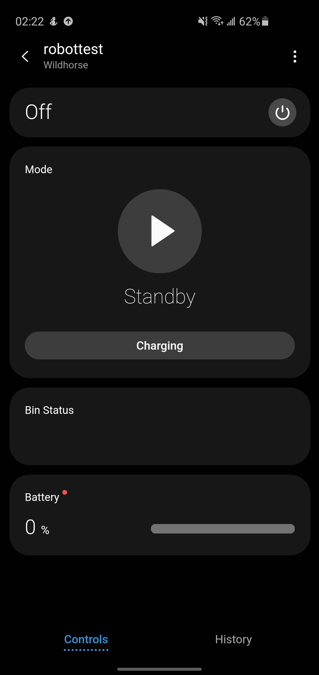

I ran smartthings capabilities:create and named my capability binstatus
I gave it the attribute binStatus, and said yes to make the setter command setBinStatus. I made a ā€˜state’ presentation json based on what orange bucket shared earlier:

I successfully uploaded it and created a device config and got the capability to display.
HOWEVER, when I do
sendEvent: (name: 'binStatus', value: 'normal')
it doesn’t work.
What am I doing wrong here? I just want the UI to display ā€˜Full’ or ā€˜Normal’ inside the Bin Status area.

That could be causing the error, it should be something like:
sendEvent(name: 'binStatus', value: 'normal')
If you get the device status and the current value of binStatus is null, it means the event is not being sent correctly.
