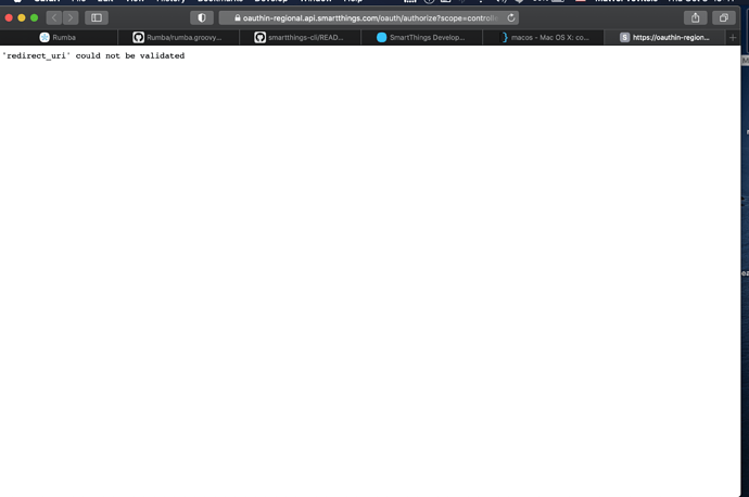

I can’t get this thing to authenticate for the life of me.
I’m on OS X. It’s installed in /usr/local/bin
Folder .config/@smartthings/cli exists
This is the error I get when trying to authenticate
You need a PAT token and the token goes into the config.yaml
default:
token: xxxx-xxx-xxxx
@jody.albritton
I generated a token with all permissions, and copied your config.yaml except replaced the xxxx with my token.
This is what I get:
Thanks, was getting the same problem and removing those two lines fixed my issue.
