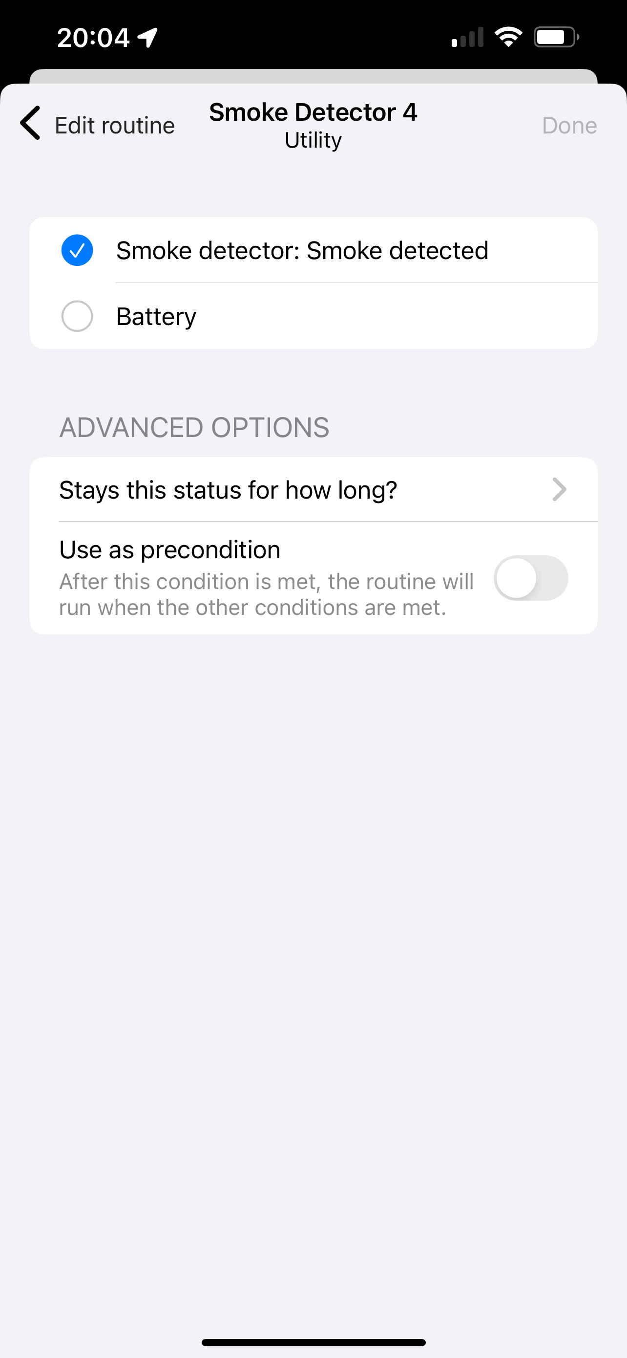

Here is my Routine for a smoke detector
and a screenshot of the IF action

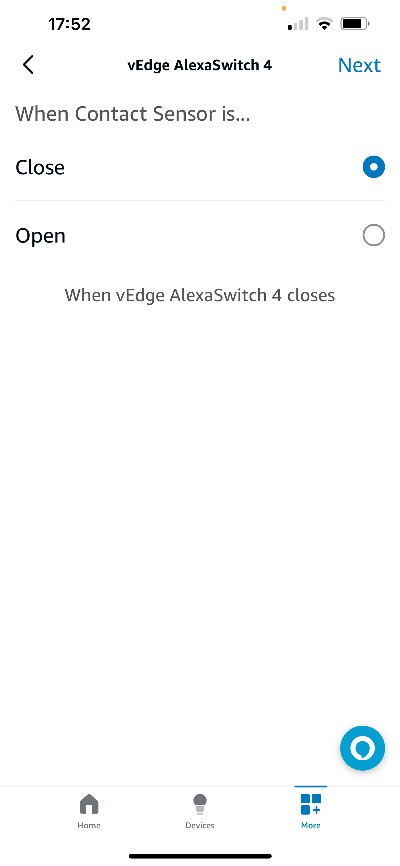

Here is my Alexa routine
and the condition eg “when contact closed”

For the screenshot above in Alexa, I believe you may have the virtual AlexaSwitch set wrong. You want it to trigger the announcement whenever the switch is is on or opens, not off or closes. In your SmartThings routine you have the virtual switch set to turn on or open when smoke is detected, so it needs to match in Alexa.

OK so I’ve made progress. I am not sure if the Virtual switch just toggles between states on activations. Changing to “opens” in Alexa app did not work. I therefore went back to the virtual switch and there is a third option Turn On or Off
