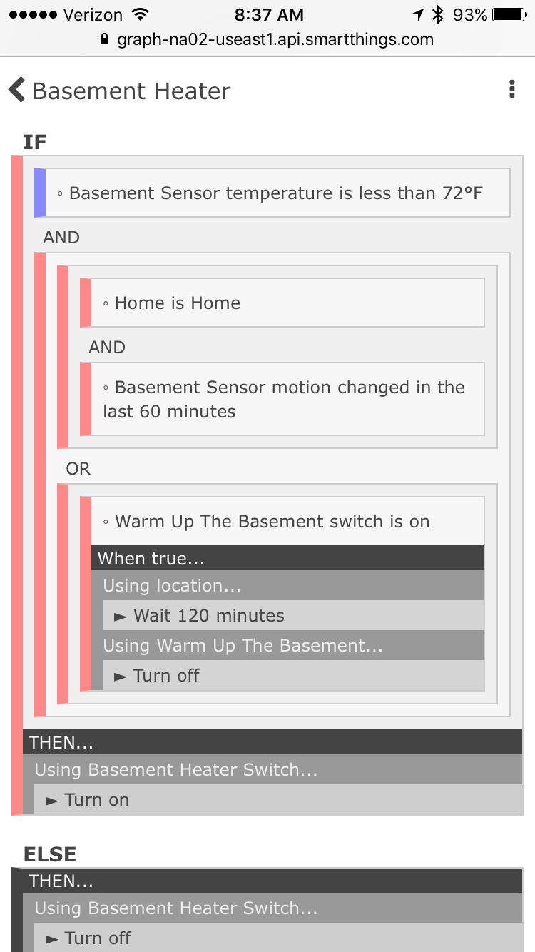

I have a piston to control my space heater in the basement that runs properly when I hit simulate, but it doesn’t seem to update itself as the variables change. What Am I missing?

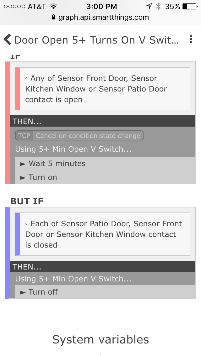

What I’m trying to do here is get a switch to turn on if any selected contact sensors has been open for more than five minutes.
Then turn off when all of the selected contact sensors are closed.
Am I thinking correctly that there should be a latching piston? Or something else? Please help. Thank you.
This should work as it is. What’s the issue?
Is 5+ Min Open V Switch a Virtual Switch that has another rule to make it work? Or is it a physical switch?
It is a v switch. It is used for this piston.
Essentially this piston turns my furnace off if something left open for five or more minutes by setting the temp super low.
I know there’s probably a million ways to do this. Using variables, and maybe even condensing these pistons in to one and not using a virtual switch. I’m open to suggestions. :grinning:
Side note: for some reason, resume schedule for the thermostat does not work unless you increase the setpoint first. It’s a known issue that sT has been working on.
I would just set the TCP to Cancel on Piston State Change instead of Condition. Condition will monitor each door so that is where the error might be happening.
Is the problem in the switch not turning on/off or in the therm?
Ok. I’ll try this. Thanks!
