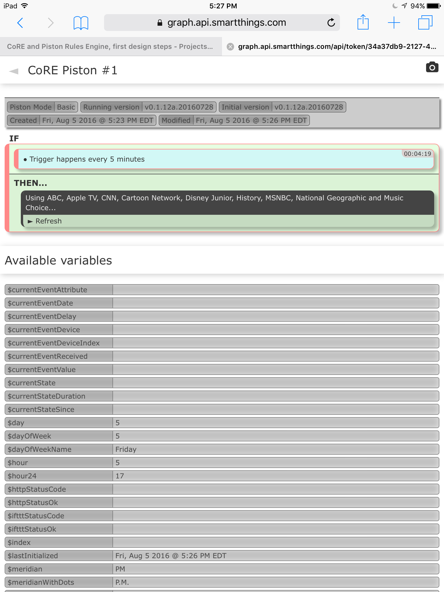

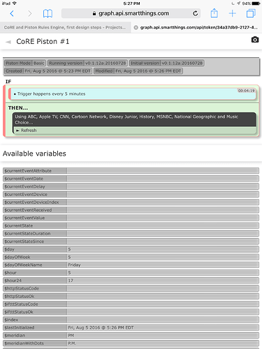

You could do something like this.
These are my harmony activities refreshing every five minutes. I’m not sure how often the harmony hub is polled by smart things, but I’d rather have them just refresh every five minutes no matter what.
I know some people that have there harmony activities refreshed not by date and time, but by if motion is sensed. So that every time motion is sensed by a motion sensor, the harmony activities are updated.

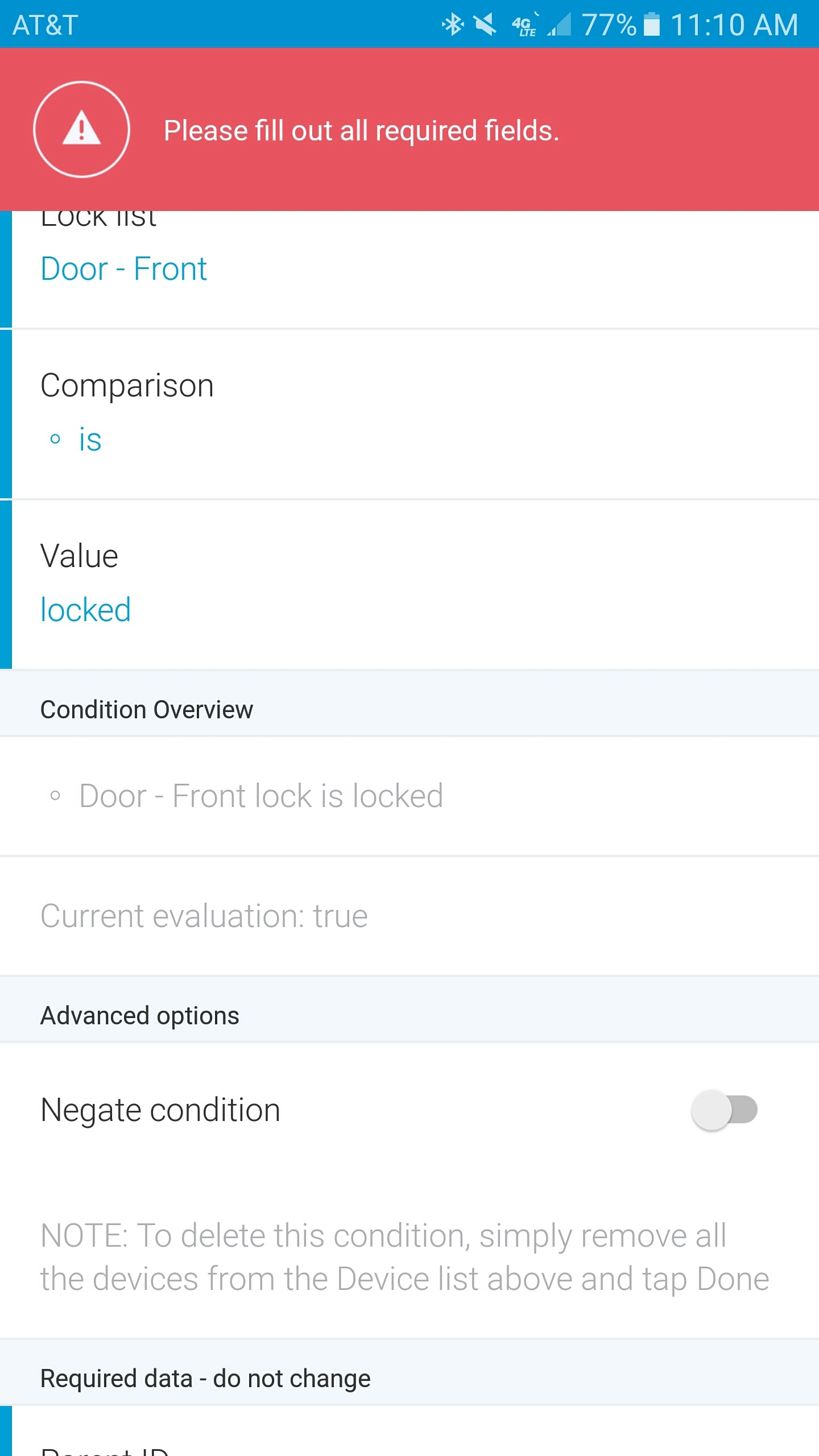

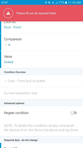

Trying to save a simple core piston but getting please fill out all fields when there are no fields to fill.
If I check and unchecked negate condition I can save it but why is that necessary steps?
Thank you.
I have had this occur at various times and I have found that hitting the back button and then the done button seems to accept the conditions that were set.
Another thing I do is change the ‘is’ to something else and then change it back to is immediately.
Don’t ask me why, but it works.
I may have read somewhere that this is an android issue. Are you using android?
Yup using a Samsung Note 5
I’ve been getting around it by enabling and disabling negate condition. Just wanted to make sure it’s not the CoRe code.
