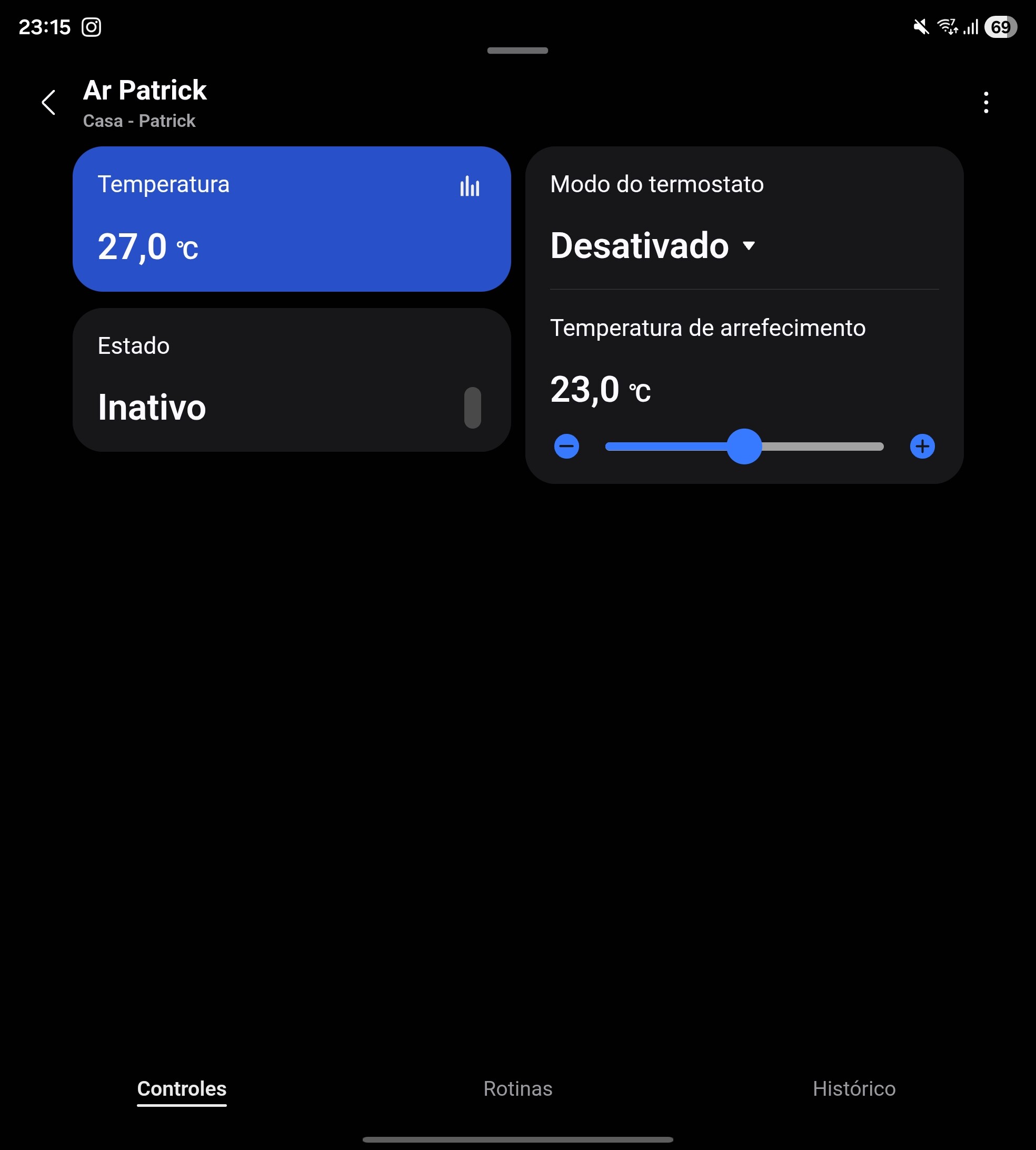

One thing that bothers me is that the air conditioner is exported as a thermostat via matter to smartthings.
Is it possible to export an AC as an AC? Whose “fault” is it?

The problem in this case is with the SmartThings driver. I tested it with LG air devices exported via Home Assistant and also with Zigbee IR devices. And in both cases, it appears this way.
Later I want to change the driver to test it.
No, I don’t have any air conditioners bridged from HA to ST.
I think the “problem” mainly lies with the HA add ons.
Both exposes climate domains as “Thermostat” devices to matter, instead of “Room Air Conditioner”.
