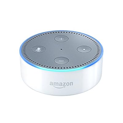

Both of these methods work with just the voice recognition that is built into the phone, you don’t need an echo or Google home. Alternatively, of course, if you get the $49 echo Dot then that would also work with any dimmer that smartthings could control, the phone OS doesn’t matter.
