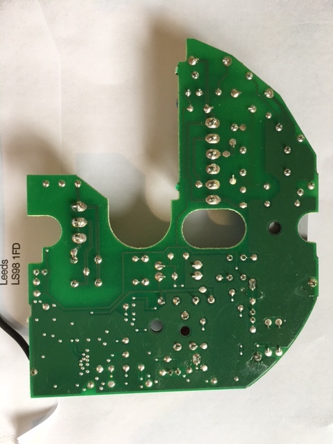

I’ll be trying again to reverse engineer the circuit board in the Aico this weekend looking for that elusive 9 (or more) volts. I’ll keep the thread posted on results. I just can’t bring myself to wire in another power source into the box, just for the binary sensor. Sadly, the current (approx 10mA) demands of the sensor put it outside the scope of a battery.
Update …
Have probed/traced the Aico relay module (Aico Ei428) circuit board. It looks as though the output from the mains (240v) regulator is 5V so that’s not very helpful for the Fibaro Binary Sensor that wants 9v-30v. Have identified the tapping in points and now ordered a Pololu 9V Step-Up/Step-Down Voltage Regulator S10V3F9 (£3.60) to get the 5V up to 9V.
Getting closer…
I think Leeo only works in the US? It’s listening for the standardized sound that smoke and co alarms make (in the US). The last several posts have been about a solution in the UK. Not sure if Leeo has a comparable product in the UK.
Success… after a false start. The step-up converter seemed to be presenting too much of a load on the board and was dropping the voltage too much. In desperation, started probing the board again and found either side of a capacitor presenting almost 12v DC. Hooked the Fibaro Universal Binary Sensor straight to this and wham, it fired up. I can now short GND to IN1 and the SmartThings Hub sees it. I’ll wire IN1 to the Normally Open (NO) contact on the relay and GND to Common ©. I’ll use heat-shrink wrap sleeving round the Fibaro UBS when I’m done just to protect it as it’s a bit naked. I’m using Stuart Buchanan’s (fuzzysb) device handler. Here’s another photo of the underside with the wiring. I’ll clean it up at some point.
