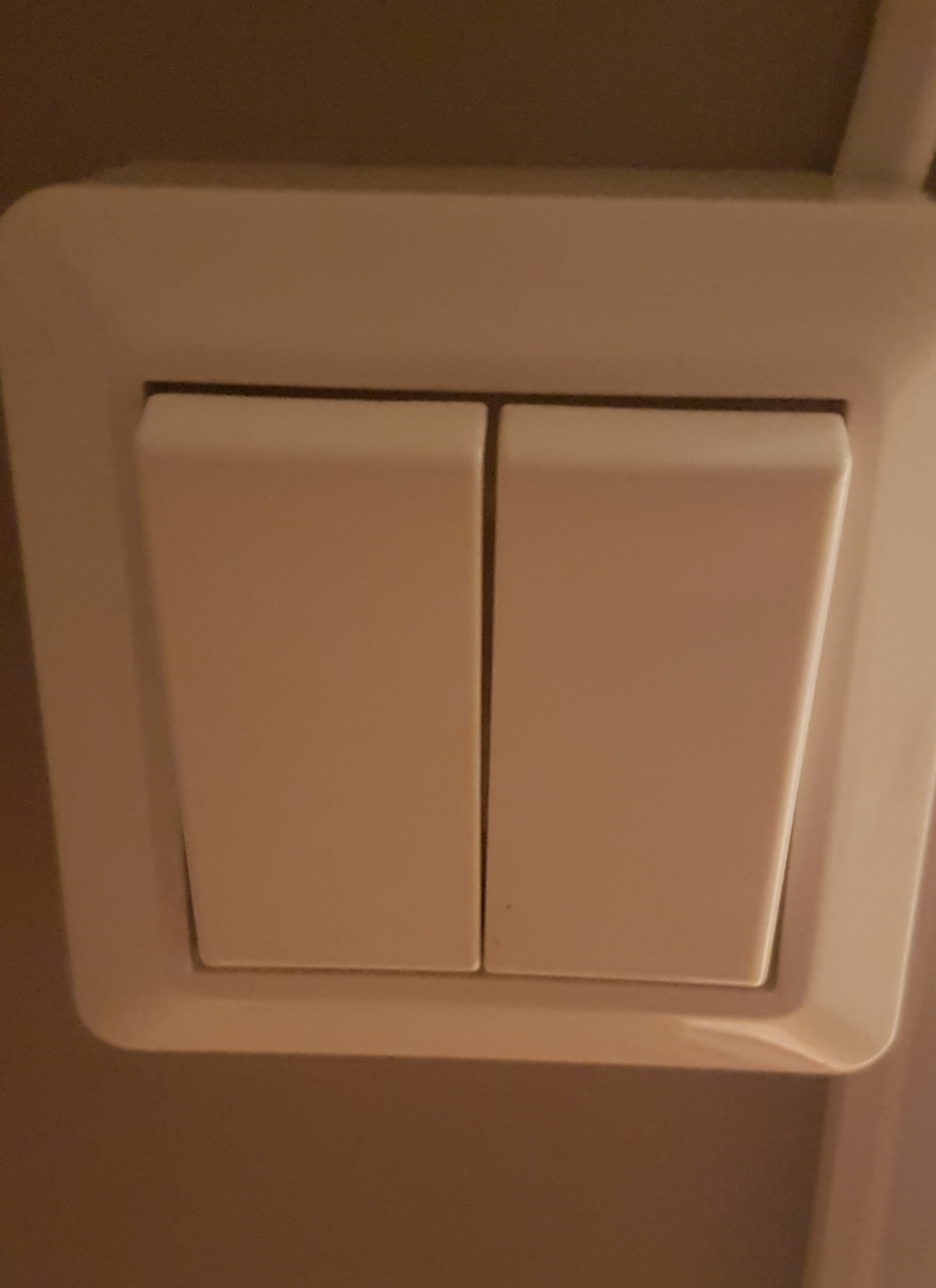

I tied two plugs to one physical part of this switch using scenes in the fibaro Dimmer. The right button controll two plugs on and off.
