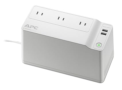

My Cable Modem, Router, and ST Hub are on a cheap UPS battery backup . Even when I lose power I usually still have Cable so still have internet as long as I keep my modem and router powered.

Correct, but the UPS I have is fairly cheap at $40, but I’m sure you can get cheaper ones. These aren’t very power hungry devices.

Also, I’ve similarly put my hub, router, and cable modem all on backup power system. I have wifi calling and online reporting of power outages, so I like having the redundancy available. Plus, I like to stream music to a bluetooth speaker while I sit in relative darkness and read a book next to an oil lamp.
