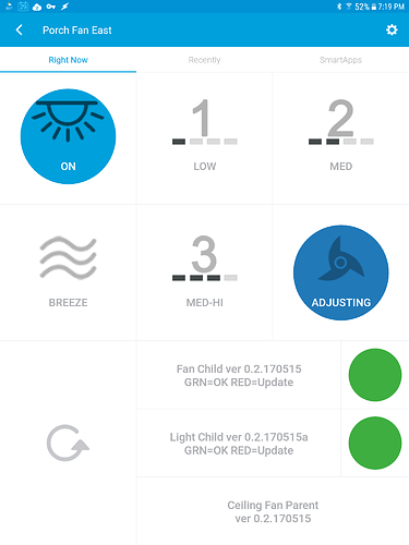

I know this is useless, but it’s all I’ve got now. This is when the controller is being ignored by ST and I try to turn it on to “High”. The fan is the one closest to the ST hub and had been good until this afternoon. FWIW, the other fan is slightly farther and, at this moment, is working.
Parent device log:
Child device log:
Shortly after posting the above, the other fan left. The time was about 7:25pm. It was running at Med-Hi and I sent two OFF commands.

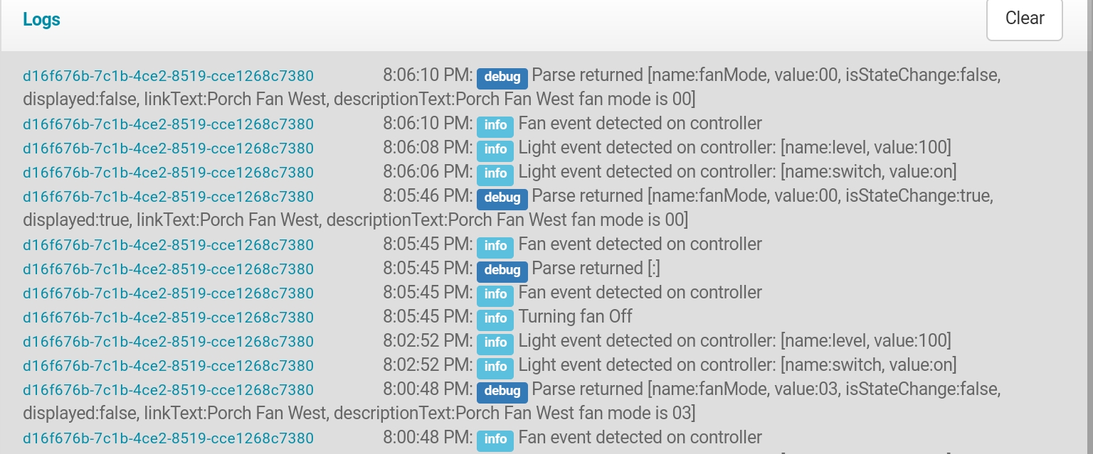

PS the “adjusting to null” you see in the last pic is probably because you used “1,2,3,4” instead of “01,02,03,04” in CORE. This should have no impact on the function of the fan but does cause the logs to display null. Easy fix for a future update.
Thanks, Stephan. Same fan as above - came back in its own. Sometime between 8:00 and 8:05pm. After an hour+ of trying, you can see the fan mode value finally changed from 03 to 00.
