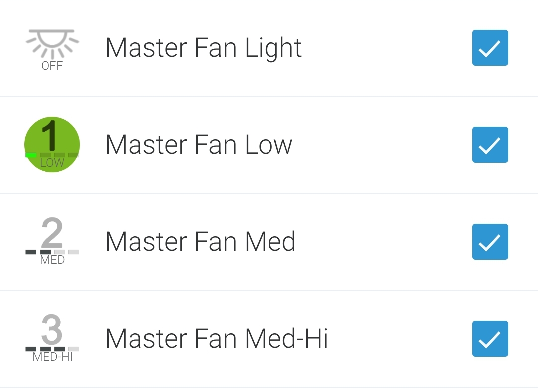

I may be missing something here but I’m at a complete loss here.
I got the Device handler and all working. Through the ST Classic app, everything works exactly as hoped. Alexa is where my issue arises. Alexa only sees a device named “Bedroom Fan” and only sees on and off. And that just turns the fan on and off. It does not recognize the light in any way. If I ask her to tun off bedroom fan light, she just turns off the fan, not the light.
Am I missing something here? Did I miss some basic step? Thank you very much.
I renamed “Master Fan Med-Hi” to “Master Fan”, so if I say “Alexa, turn on Master Fan”, the Med-hi setting is the default. This also makes it easier to turn off: “Alexa, turn off Master Fan”.
