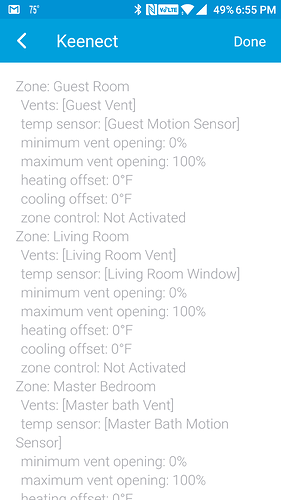

So, a little weirdness here, in Arizona, my AC kicked on and all of my vents went totally closed. Even if the setpoint is below the current temperature.
One of the vents is being set to zero every minute. What logs do you want?
it sounds like you have only setup the heating component of the system.
Under smartthings / automation launch the keenct app, in the main app verify you have selected system is AC capable.
For each zone then set a cooling temp or offset based on your setup.
Please then share a keenect log and one of your zone logs.
