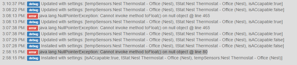

Just tried installing, can’t get it to work,
Getting java.lang.NullPointerException: Cannot invoke method toFloat() on null object @ line 80
in logging
I tested some more, it only happens when I say the system is AC compatible.
and more testing
So I had my nest set to heat only (for the winter) and Kennect fails when set to AC Capable. So I went into my nest and set it for Auto switch between Heat and Cool, now Kennect works

I have seen this before with nest, especially with new nest units connected to smart things. When in heat or cool only nest does not send smartthings setpoints for heating and cooling hence the error. After the zones are installed you can set back to heat or cool only.
FYI, Megan your correct both line 80 and 465 reference the cooling setpoint.
