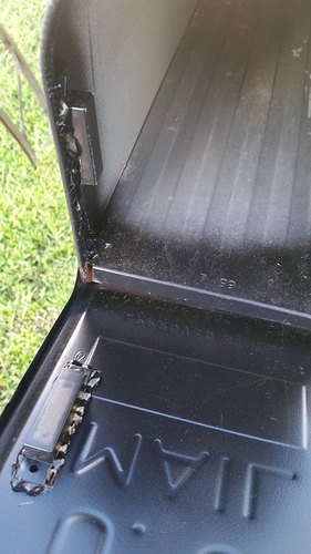

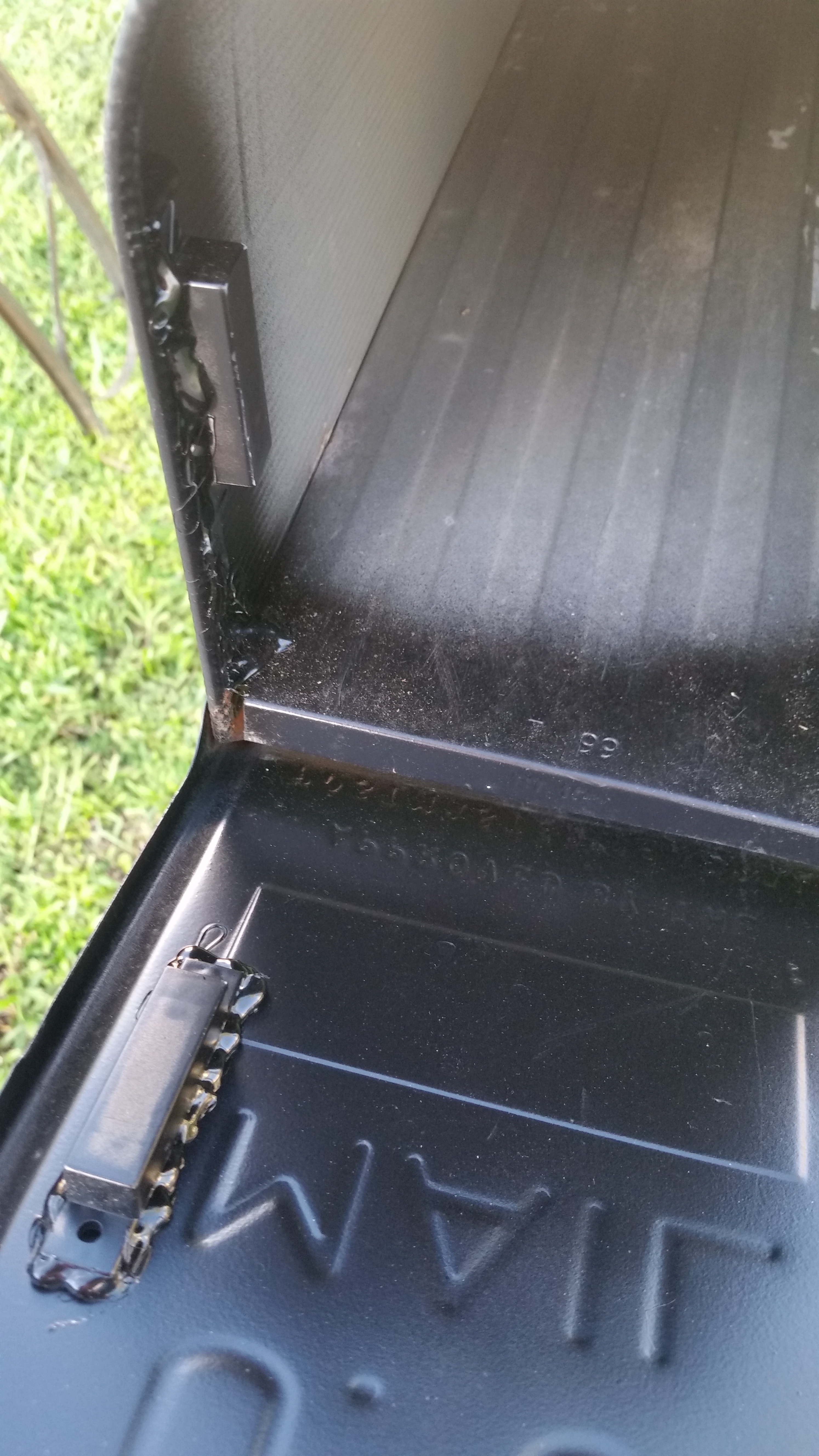

I attached this to an Ecolink Garage Door Tilt sensor for our mailbox. Works very well. The sensor is in the mailbox and the magnet is on the door. I attached it using hot glue. Been installed all summer in the Florida heat without an issue.
Do you have the Ecolink tilt sensor outside the mailbox? My mail box is metal and therefore I will have to mount it outside. Also, did you do anything to the internal ball switch in the Ecolink? I am confused by how this works. If the Ecolink is stationary, the ball switch will be in either open or closed position (depending on whether the Ecolink is in a vertical or horizontal position). Does the door contacts sensor (the one you have linked to) trigger through a separate (and independent) channel?
The tilt sensor had internal contacts to add the external sensor I listed. The tilt on the door was extremely unreliable. The external sensor only worked with the ball in either the open or closed, not both. I think it was open. I bent the ball switch to keep it in the correct position. I mounted the Ecolink under the bottom of the mailbox. I think I have some pictures. If I can find them I’ll post. The mailbox is close to 40ft from the hub going through one external wall that also contains a 6ft patio doorwall.
I used the tilt sensor because I had one I was no longer using. I didn’t buy it for this project.
Top picture is the sensor mounted under the mailbox. Button picture is the external sensor mounted so it reads the door being opened and closed.
Thank you. The pictures were very helpful. That is exactly what I was planning to do. What is the black stuff used to glue the magnet and sensor to the mail box? and did you use hot glue to glue the tilt sensor to the bottom of the mailbox. Also, did you paint the magnet and sensor black? Most of the sensors I have seen are white and they would stick out like a sore thumb in my mailbox, which is also black like yours.
I used hot glue for the tilt sensor and the sensor and magnet in the mailbox. When I was finished with the glue, I painted everything black. I also used hot glue on any wires just to keep them from flopping around.

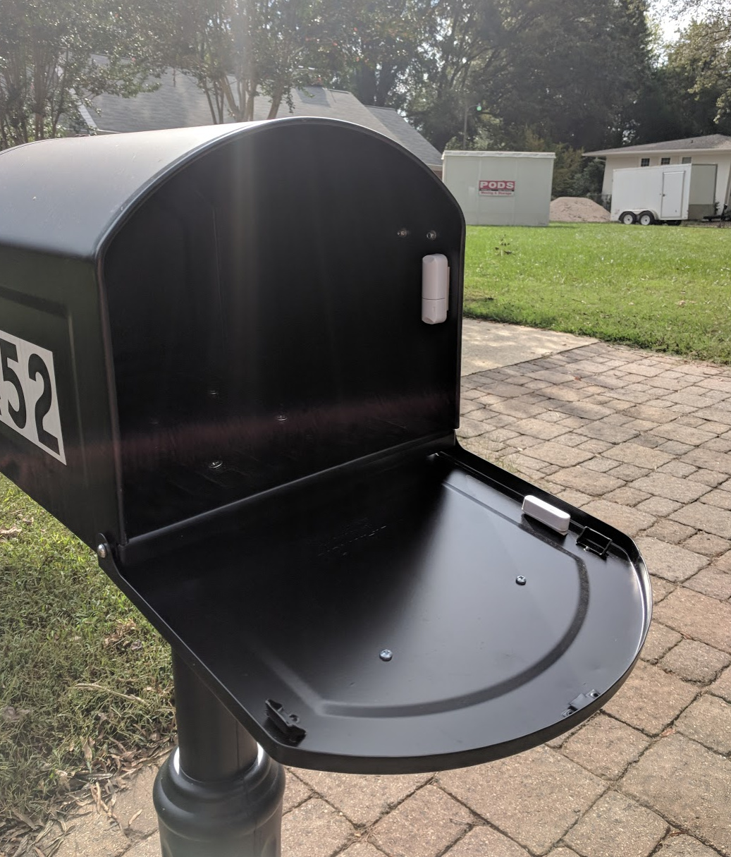

I’ve been using this Iris window door sensor for more than a year and it has worked flawlessly through the cold winter and now a hot summer. My mailbox is 60 feet outside the closest of my z-wave repeaters on the inside of my house.
I use Iris plugs that have both z-wave and zigbee radios throughout my house for repeaters.
https://www.lowes.com/pd/Iris-Iris-Indoor-Door-And-Window-Sensor/999925302
Is you mailbox metallic or non-metallic? Does the iris window/door sensor have the option to connect an external magnetic reed switch? If not, it will not work for me because I have an all-metal mailbox, so I cannot have the sensor inside the mailbox.
All metal.
I installed the Iris door / window sensor that you linked to and it works great! The response time is very fast and now reliably get notified when the mailman delivers the mail. I have both the Monoprice garage door tilt sensor and the iris sensor now installed in my mail box and today when the mail man delivered the mail, only the iris sensor notified me. Thanks!
