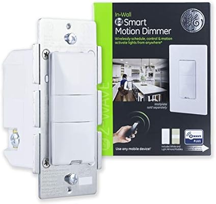

If you are in the US, there is a GE brand smart switch that works well with smartthings and has an occupancy sensor built into it.
Here is the manufacturer site with the full specifications. But shop around, it usually sells for a little under the list price.
