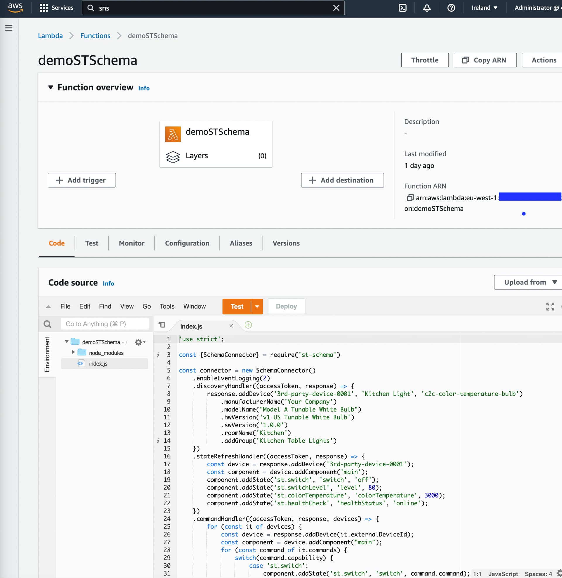

My Lambda function is deployed in eu-west-1, so I think that’s OK
AWS CLI is configured for eu-west-1 and admin user (same as used to create lambda function)

The Lambda function has the node_modules folder / files, my lambda function filename is “index.js”, and runtime settings is set to “index.handler”.
