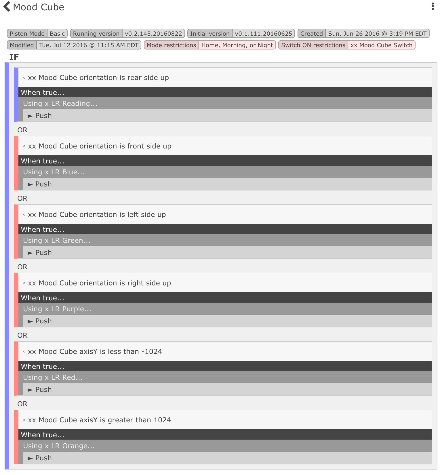

I switched over to CoRE a little while ago and created a piston that does what the app does, and a whole lot more. It has made me fairly jaded towards the concept though, because the sensor itself is quite slow to report orientation changes. I’m going to try changing out the battery soon to see if low battery charge has anything to do with its slowness.

Would you mind sharing the core app?
Thanks,
Nitin
Sorry, I wasn’t clear. I meant the Piston, I have core but am pretty new to it.
On my setup, I’m also using Hue Lights, Groups, and Scenes app and device handlers because the color scenes can be saved as virtual buttons, which change the colors of groups of lights very quickly. Here’s a pic of how my piston is set up:

Thank’s for sharing your piston structure, I’ll give it a go…
This is a great idea. I like the idea of using CoRE pistons to do the grunt work (more flexibility in the result of each turn.)
