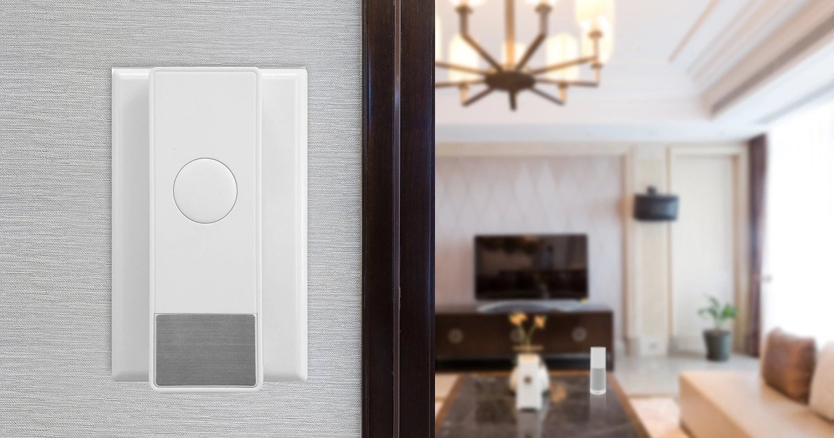

You could go with the Echo plus, since she is use to Alexa devices. It only handles Zigbee and I think some Wifi devices.
Also for light switches with no neutral I have had good luck with Thirdreality switches listed below. The house I just bought was wired with most switches having no neutral. I had most re-wired and added neutrals but I still have a couple that do not. These switches have worked well for me, and they do work with Echo plus. No real use of motion with this approach though, but Amazon seems to be adding capabilities at a pretty good pace, so they may have something some day.

As far as the third reality switch cover, I have one at my house connected directly to an echo show second generation specifically so I have voice control if the Internet is out. So it’s the back up to my back up system. :wink:
But most people who come over think it looks really weird. So that’s another factor, although I think the newest all white model may help with that issue. On the one with the silver block at the bottom, people kept trying to push that instead of the actual button.

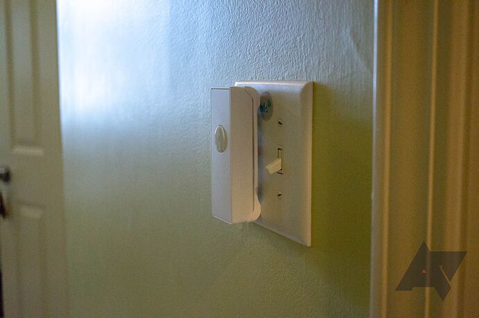

Good suggestion on switches that actually flip another switch. I assume these are battery powered right? I assume these work by pushing the round button and that toggles the underlying switch back and forth right? Not independent on and off.
One final pretty unrelated thought, is I just convinced my Mom to switch over to Android from Apple. she had an old Iphone 5 she got refurbished from Verizon for $100 and almost keeled over when she saw the prices of even the many generations old Iphone 8. A cool $300 got her the Moto G7 which has been great so far. . . .but clearly won’t play well with Apple and their HomeKit.
(Mike) #7
They use 2 AAs, and they can operate a toggle or paddle switch. You push button and it mechanically flips the switch.

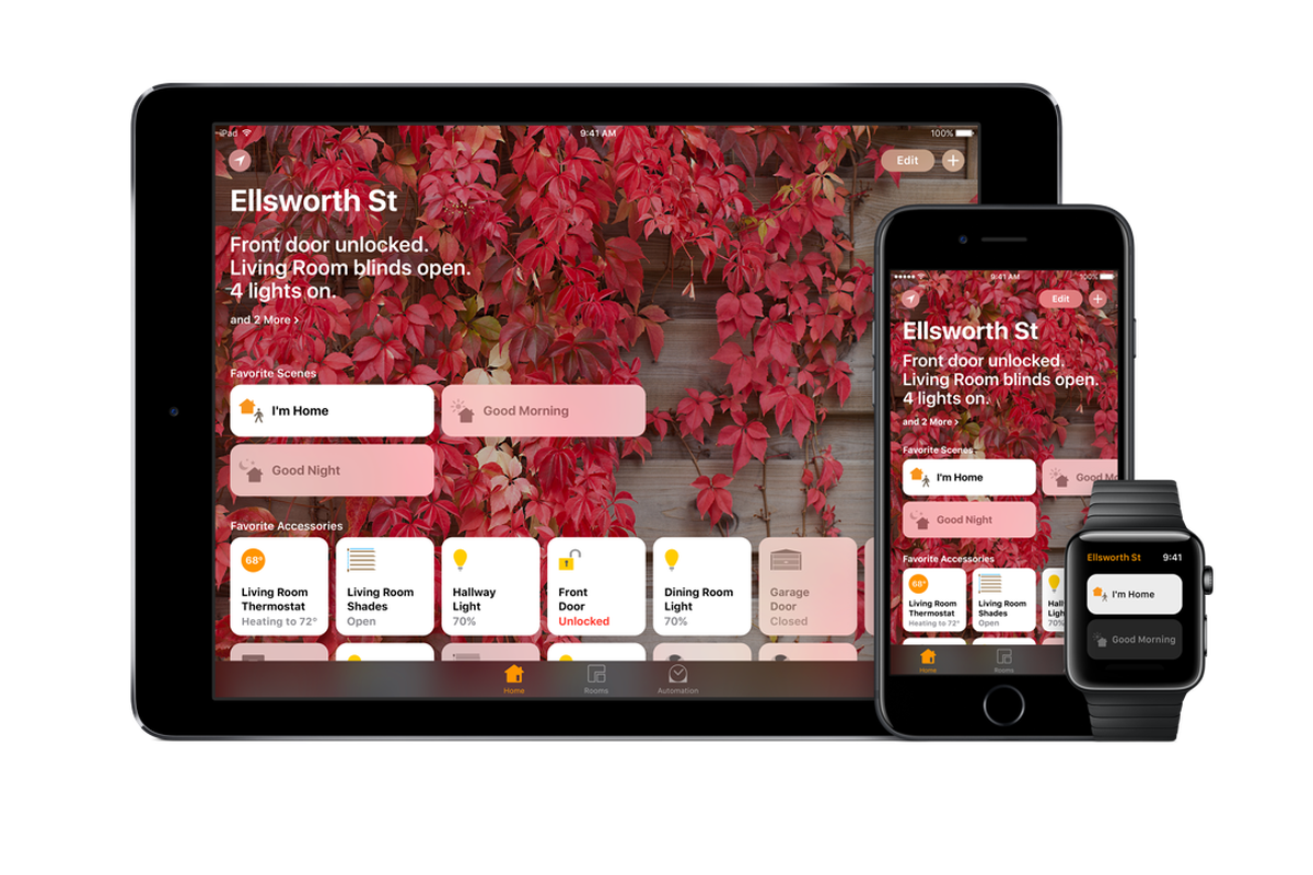

HomeKit is an Apple feature that allows Siri (apple’s voice assistant) To talk to end devices that are HomeKit – certified. Siri can both Control them and query them for status.
In addition to Siri, there is a HomeKit app built in to iOS so you get a dashboard that way.
Everything runs locally except the Siri voice parsing, and that can use cellular on an iPhone, iPad, or Apple Watch.
If you want to be able to control your devices when you are not at home, then you add either an iPad at home or an Apple TV streaming box so you get Internet access. But again, you don’t need that while you are at home.
If you want to be able to set up rules so that the motion sensor triggers the lights or one light switch follows another, then you need to have either a plugged in iPad that stays at home or An Apple TV streaming box and that then acts as a hub. But again everything runs locally.

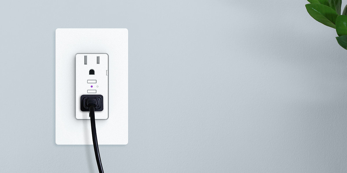

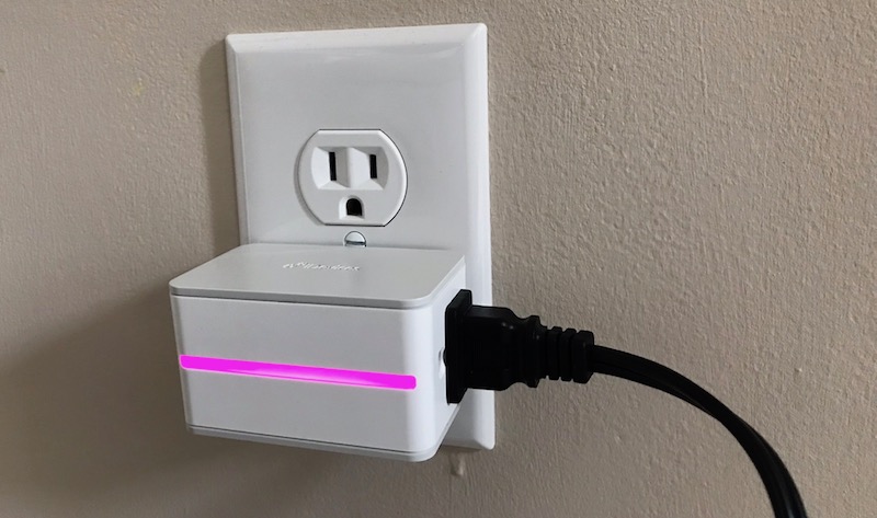

IN WALL OUTLET
JDRoberts:
IDevices WiFi inwall Outlet
What’s the thinking on using these vs just plug in? Just because it gives you two controllable sockets?
Mostly aesthetics and simplicity. You don’t have to worry about somebody unplugging it and moving it somewhere. It just looks like a regular outlet.
I have one health aide every single time she wants to plug-in the blender, she unplugs the pocket socket first. :scream:
So this:
Vs this:
Optional, but I just thought some people would like to know that option exists. :sunglasses:

Is the 2nd Generation of ThirdReality Smart Light Switch quieter. I have the Gen1 and it is noisy.
#12
Still much noisier than a device that doesn’t physically move the switch underneath, but it is somewhat quieter than the first generation.
From the manufacturer:
Compare with Gen1, it is simple and clean, quieter and thinner. Better on connection range and lower on battery consumption.
Note that some reviewers report that it works fine with Alexa, but the Google assistant integration is still buggy:
