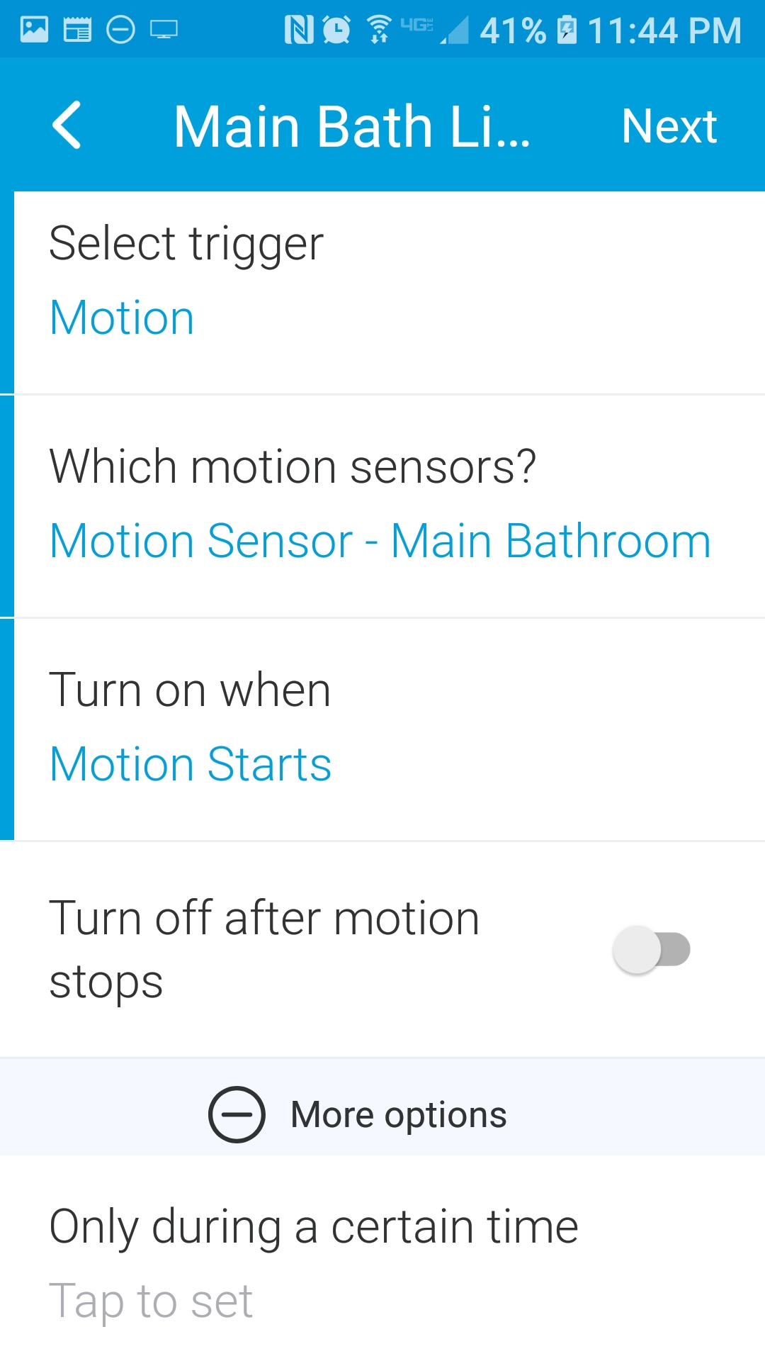

When I was using WebCORE, I did it all within one piston. When I moved everything (well almost everything) to “native” ST apps, I used a virtual switch and 3 Smart Lighting rules.
Rule #1 - open/close sensor turns the virtual switch on/off.
Rule #2 - turn on the bathroom light when motion is sensed as long as the virtual switch is off.
Rule #3 - turn off the main bath light (after 5 minutes) when motion stops as long as the virtual switch is off
I am sure there are other ways to do this but this one worked the best for me in Smart Lighting.

Rule #2 - light on w/motion. For this rule, ignore my DND switch and use your virtual switch. I have another interlock to keep the light from illuminating if I have house guests. Also, if you always want the light to turn on with motion, you don’t even need to put a switch in for the “only if switch setting”. I like it because in the morning, when I use the main bath for a shower, I like the subdued natural light.
