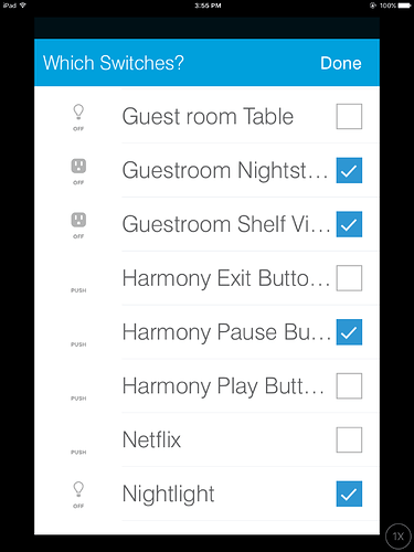

Buttons are a type of switch and will be listed in the switches category of the IFTTT smart app where you authorize which devices IFTTT has access to.
For example, I have several harmony buttons which are momentary switches. You can tell from the icons on the things list in the screenshot:
When I go into the IFT TT smart app, you can see that they are listed in the switches category.
You authorize them like any other switch, and then they will be available for use in IFT TT recipes.

I knew it was a kind of switch. I added a virtual momentary button, but when I went to IFTTT.com (desktop browser) and “reconnected channel”, my button wasn’t listed under switches. Perhaps because it was a virtual button?
Are you using a custom device handler or the standard virtual momentary? If it’s custom, maybe it’s an issue with the device handler
You have to authorize each device you want IFTTT to have access to from the SmartThings side before you will see it in your IFTTT.com channel.

  1. open the IFTTT smart app
  2. choose Switches
  3. check your new virtual button, as I did in my harmony button example above
  4. continue through the smartapp to finish authorizing your devices
  5. now you can go to Ifttt.com and you should see the button in your SmartThings channel

You actually can do it too via IFTTT if you reauthorize channel. When you click that you go through the OAUTH authorization page and can select them. It’s quicker to do it through the ST app, but it’s still doable directly through IFTTT like @jnhearne did

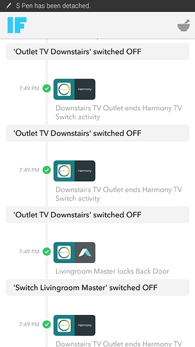

Can someone check their recipes log on IFTTT side? I am seeing multiple (3 or even 4) recipes fired consecutively for same teigger. I know it’s related to ST, because I have other channels and not seeing the same behavior. Anyone else seening the same?
hmmm… I’ve kind of stopped IFTTT from operating anything through ST and only use IFTTT to provide backup commands (for instance IFTTT -> Wemo(directly)) for when ST fails. Until ST can figure out their stability problems, I’d see if you can come up with an alternate method. It sucks, yes. But banging your head against the wall sucks more.
But I did check my IFTTT logs and I’m not getting repeat fires. Normally I’ve seen in the past that this is what IFTTT does before the recipe self-turns-off.
