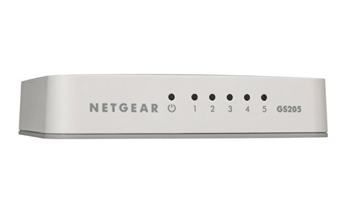

I also have a couple of questions to ask you, but they have nothing to do with this thread. But here goes - with all the equipment how many routers are you using? I only have one slot left on my DSL Modem. Assuming you have more than one, do they interfere with each other?
I think you should only need one router, even if you had hundreds of wifi or Ethernet connected devices on your network (whether you have enough bandwidth to use that many devices is a different issue). Do you mean the Ethernet ports on the back of your modem? You could just buy an Ethernet switch to get more Ethernet ports. Sorry if I’m way off, I haven’t had dsl in like 15 years, if you’re referring to something else.
There are a lot of different ways to set up multiple networks, or to add to an existing network, so you should probably set up a different thread under projects if you’re interested in talking about that. :sunglasses:
If you just need more ports, though, the easiest thing is just to add an Ethernet switch. This is a device you plug into the router to add additional ports. Here’s a good article on the pros and cons.
