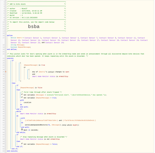

I was using this piston successfully until Echo Speaks was eliminated by Smartthings. Iâm wondering if this can be modified to work now by substituting the Echo Speaks devices in the âDoâ section of the piston, with a Voice monkey URL request that would speak the Message variable of the piston using the particular Echo device referred to by the Voice Monkey. I have not been able to code this successfully, given my level of understanding. If this can be done, how would the coding be done in the lines that need modifying? Also, advise if any special coding needs to be put into the Monkey URL. Thanks much for any help you may offer.
Thanks for sharing your solution. However, I am having difficulty properly coding the announcement portion of my Monkey URL. When piston fires, the log portion for the get request returns the following error.
| +202ms | ââSending external web request to: api-use.voicemonkey.io/trigger?access_token=a6d46f7ae4adadc767edee9e55b174fd&secret_token=73cef184dfc22e8dce0626fe49856e84&monkey=echo-show-monkey&announcement=%20urlEncode("$currentEventDevice"%20was%20"$currentEventValue") |
| +204ms | ââError executing external web request: java.net.URISyntaxException: Illegal character in query at index 181: https://api-use.voicemonkey.io/trigger?access_token=a6d46f7ae4adadc767edee9e55b174fd&secret_token=73cef184dfc22e8dce0626fe49856e84&monkey=echo-show-monkey&announcement=%20urlEncode("currentEventDevice"%20was%20" |
Perhaps you can recommend the exact coding I need to fix this error. I will post copy of piston.
Thanks for your valuable time and help.
