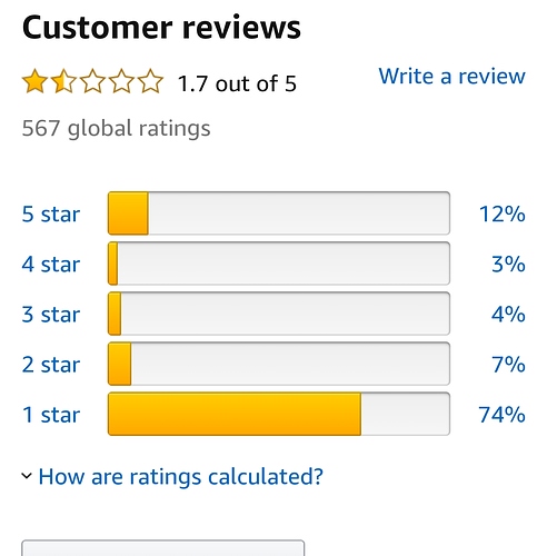

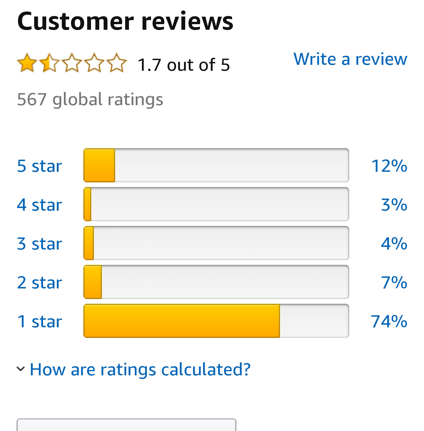

After the relink I have not had a single issue. It’s only been about 10 days, but so far, it has proven 1000 times more reliable then the Samsung Alexa skill, which is now up to a 74 percent 1 star rating
strange, when i look at it there’s only 110 global ratings and 1.9 out of 5 stars
I wonder if the ratings system is different in the U.S. versus outside the U.S. Are you outside the U.S., or at least does Alexa ā€œthinkā€ you are?
UK - I thought about that after posting. Still, 1.9 is not exactly world beating.
