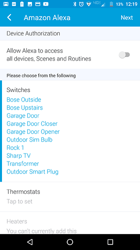

How do I do this? In the Amazon Alexa SmartApp in SmartThings, you turn off the ability to allow Alexa to Discover All Devices / Routines and then you specifically select all devices that are in SmartThings only that Alexa can’t discover on her own, and then you can also include the Routines. This will prevent unnecessary duplication of devices in Alexa.

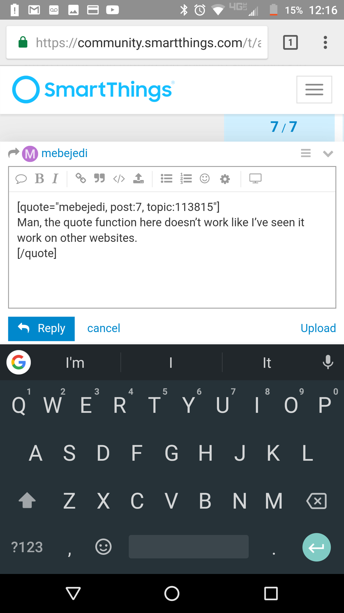

[EDIT] Man, the quote function here doesn’t work like I’ve seen it work on other websites.
Quote works fine if you highlight the text and press Quote
Go into the Amazon Alexa SmartApp in SmartThings and turn the option off so that Alexa will not Discover anything from SmartThings:
After you have performed this, then follow the steps to Forget All of the SmartThings devices.
Then go back into the Amazon Alexa SmartApp again and select only the devices that Alexa hasn’t already discovered (non SmartThings). If those devices were already discovered by Alexa, you don’t select the same ST Device.
Then you can go back to Alexa app and have her Discover Devices. This time she will only add the SmartThings devices you specifically selected in the Amazon Alexa SmartApp inside SmartThings.

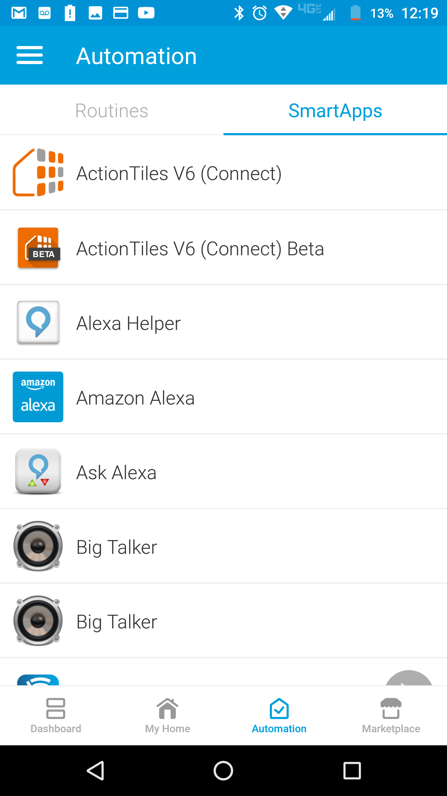

Okay, Amazon app is installed, and I got it to only detect my two Z Wave light switches. Weird thing…the Amazon Alexa app shows up under automation in my ST app, and on one section the ST website (My Locations → Home → List Smartapps), but not under “My Smartapps”.
ikr? I just into all this Smart Home stuff last week. There’s a lot of little things to keep track off. Definitely not for the faint of heart, lol. It’s tough to set up, but awesome when you get it going!
It might say “My Apps” but that’s not what it means.
The Marketplace of “+ MyApps” shows any custom SmartApp that you created code for in IDE that you can select and Install. It doesn’t mean your Apps. It means custom SmartApps that are available for you to install.
Any SmartApp that has been “installed” (a couple of exceptions) by you from the Marketplace will show up under Automations / SmartApps <----- Those are your SmartApps.
