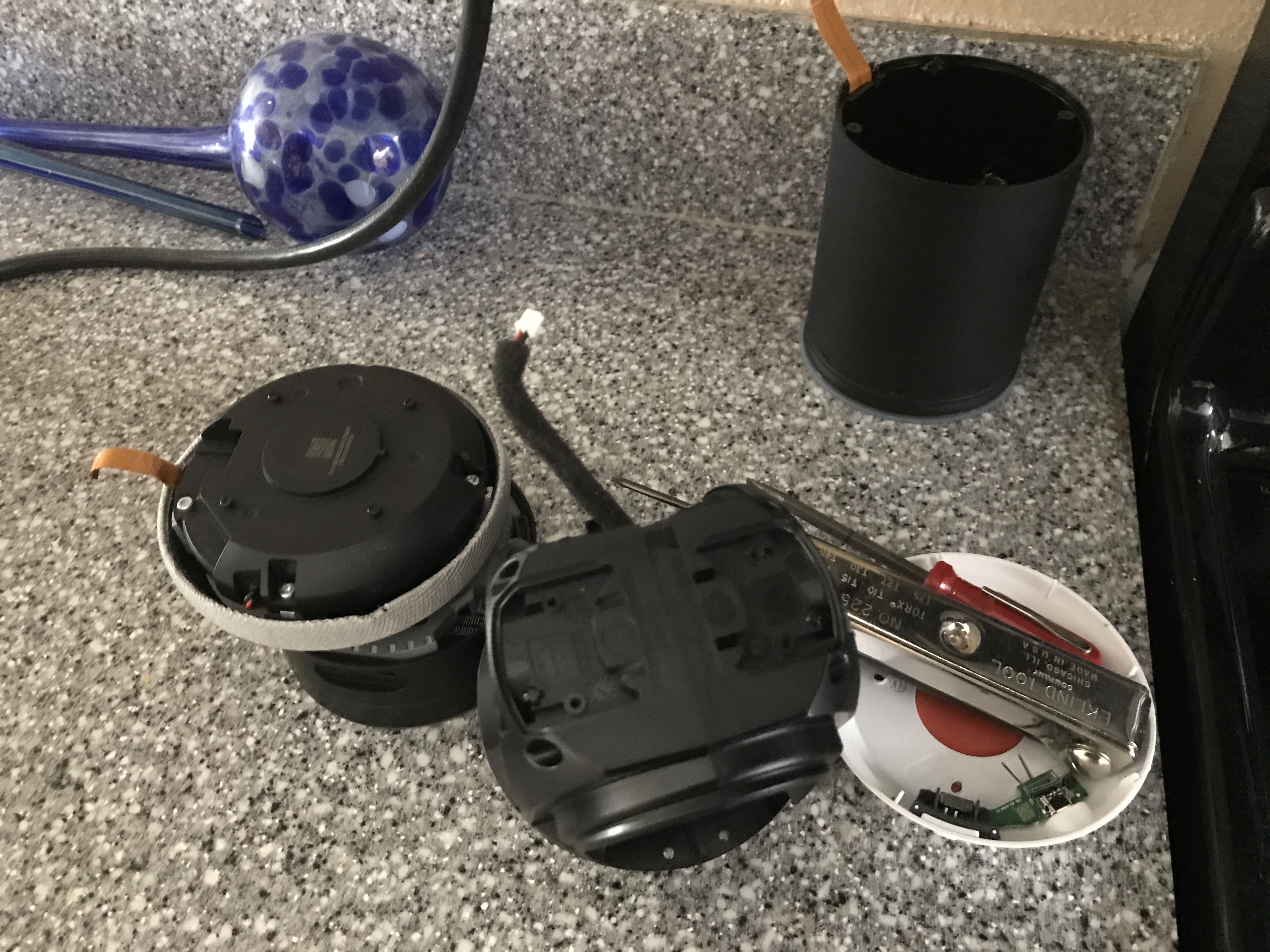

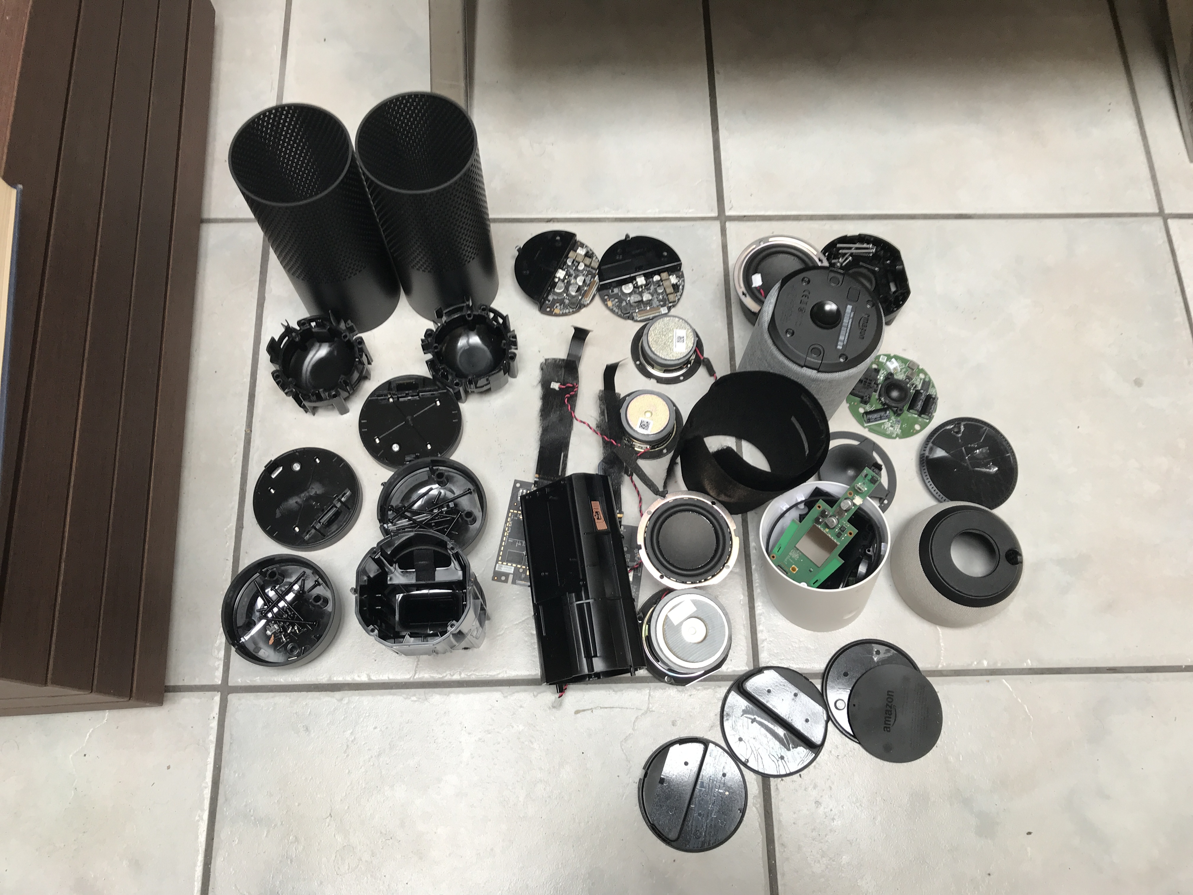

I solved all my issues with home voice assistants yesterday.
