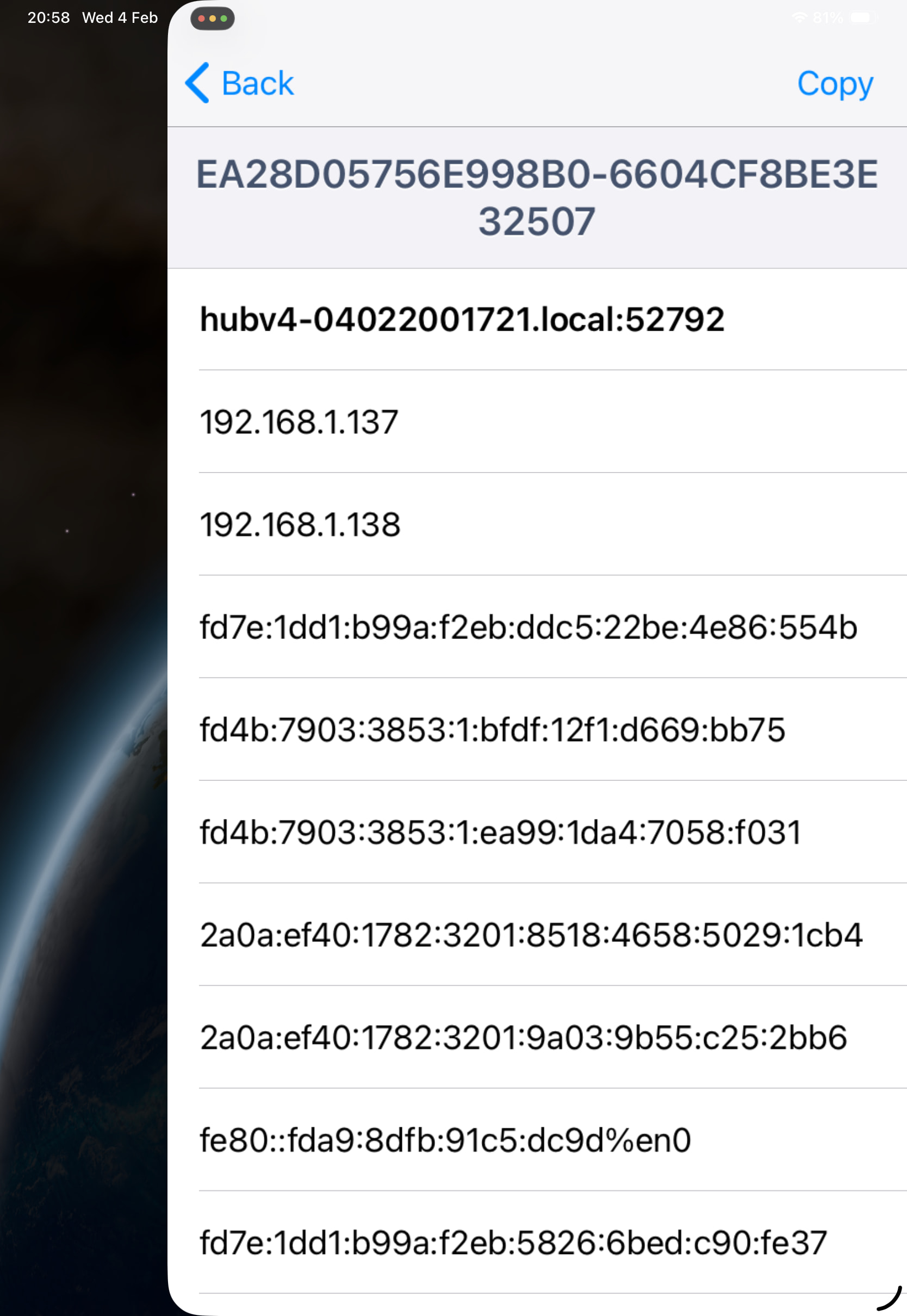

Your hub is advertising itself as a Matter commissioner and Thread Border Router on your LAN.
Specifically:
SmartThings Hub #87A4**._meshcop._udp.local.**
This is a Thread Mesh Commissioning Protocol (MeshCoP) service advertisement that indicates that the device is a TBR and commissioner that can form a Thread network.
hubv4-04022001721.local:49154
.local → mDNS domainname
49154 → MeshCoP UDP port
IP Addresses
Every address the hub is reachable on, across multiple scopes and fabrics.
192.168.1.138:49154
192.168.1.137:49154
There are two IPv4 addresses likely a Wi-Fi and Ethernet interface
fd4b:7903:3853:1:bfdf:12f1:d669:bb75:49154
fd4b:7903:3853:1:ea99:1da4:7058:f031:49154
Two IPv6 ULA on-mesh addresses
fd4b:7903:3853:1::/64
This is a Thread on-mesh ULA prefix. This hub is actively participating in the Thread mesh and has multiple Thread IPv6 addresses which is common for Border Routers (router + leader roles, multiple IIDs). Given this is a Smartthings hub, it also being used as the Off-Mesh Route prefix which you could confirm by looking at the route tables of devices on the LAN. This prefix is Thread-internal and ISP-independent.
fd7e:1dd1:b99a:f2eb:5826:6bed:c90:fe37:49154
fd7e:1dd1:b99a:f2eb:ddc5:22be:4e86:554b:49154
These addresses are from the mesh-local prefix fd7e:1dd1:b99a:f2eb::/64. They are used for Thread routing, leader election, and network control traffic. They are not routeable, never affected by the ISP, and never used by Matter controllers directly.
fe80::8de4:c637:b6de:2cf8%en0:49154
fe80::fda9:8dfb:91c5:dc9d%en0:49154
These are the link local addresses of hub. %en0 is the iOS Wi-Fi interface. These are used for for same-link communication and confirms the iOS device and hub are on the same L2 LAN and that mDNS is not being relayed.
2a0a:ef40:1782:3201:8518:4658:5029:1cb4:49154
2a0a:ef40:1782:3201:9a03:9b55:c25:2bb6:49154
These are the Global Unicast IPv6 addresses assigned by your ISP (confirmed to be Vodafone via whois) from the prefix 2a0a:ef40:1782:3201::/64. These are globally routeable and assigned via by your ISP via RA or DHCPv6-PD. It tells you that your hub has direct Internet connectivity and may advertise an off-mesh route into the Thread mesh, but not this specific prefix.

This tells me that on the LAN side of your hub, things appear to be working as expected. Tells us a little about the Thread mesh side in that the hub appears to have all the necessary prefixes and constructs created to operate a functional Thread mesh and TBR.
Your ISP router has nothing to do with managing/maintaining the Thread network and the fact that it drops the mDNS packets in no way affects the ST Hub and its function as a TBR. You could have a functioning Matter network that supports Matter over Wi-FI and Matter over Thread without having an ISP router at all (not Smartthings since it is Cloud dependent).

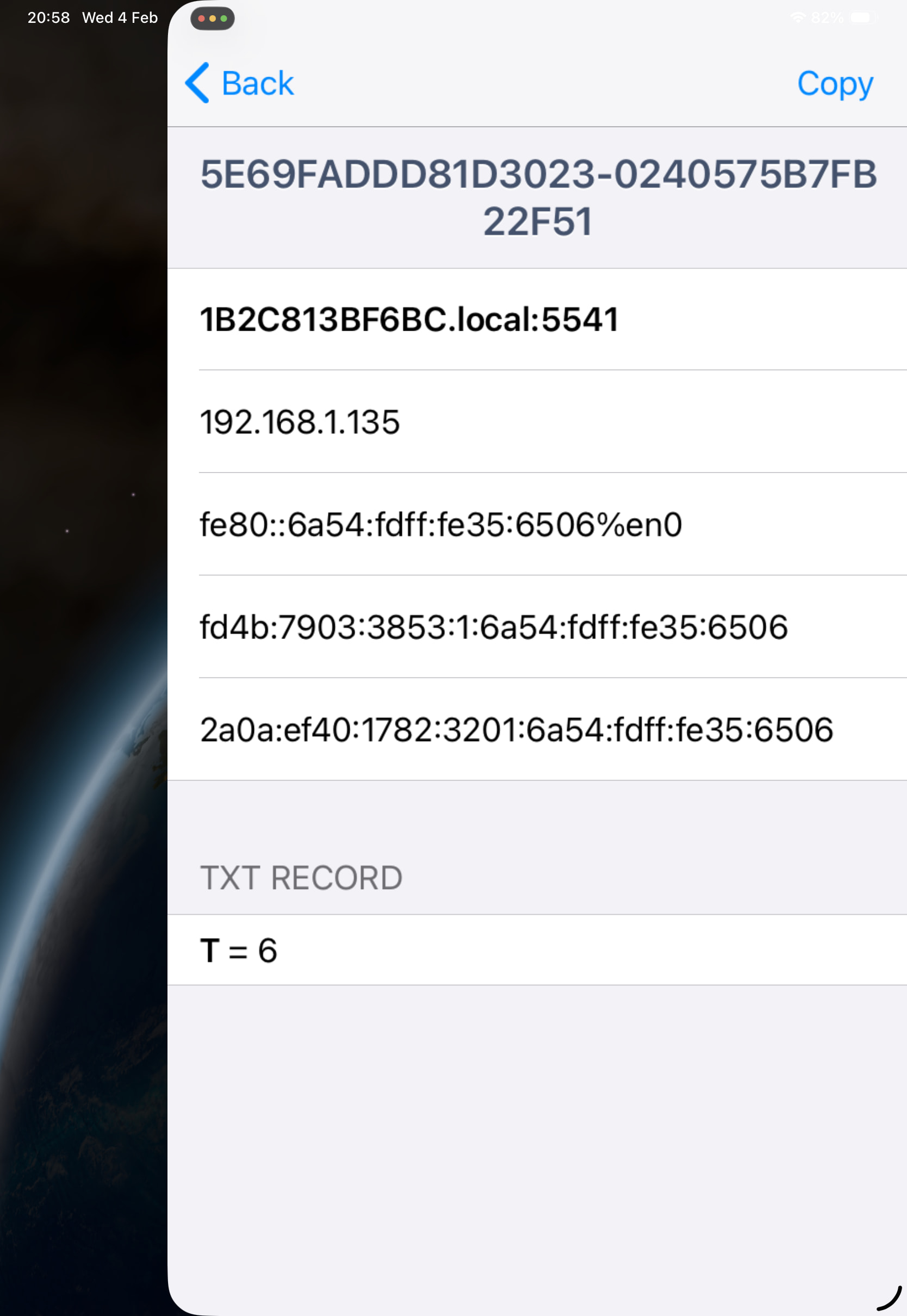

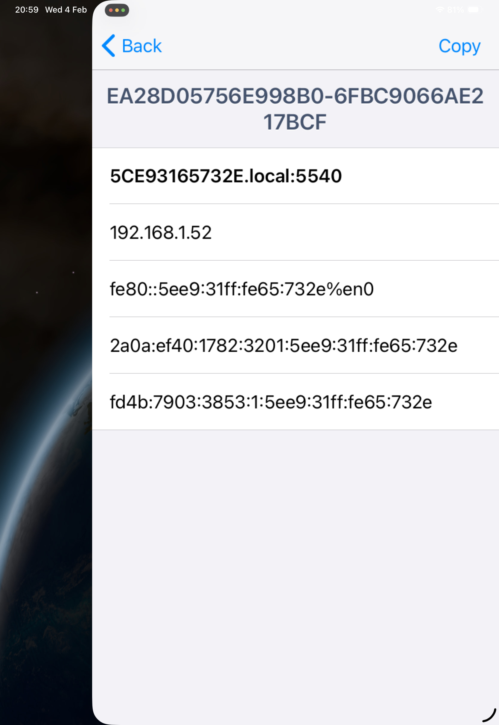

So, you have 28 Thread devices on your mesh. Did you receive more responses for the dns-sd or just the 9 you listed? If just the 9, are all the devices on the mesh Matter capable?
So, for at least 9 of the Thread devices, you are seeing valid service announcements and in theory you should be able to ping the fd4b address of those devices from your iOS device. If that works, then the hub is performing its TBR function properly.
It would be interesting to look in the AWA or CLI to determine what those 9 devices are. As I mentioned in an earlier post, you can use the Instance Name to locate the specific device in ST.
All my matter devices, the only 2 online are matter over WiFi.
Discovery output doesn’t include instance name so hard to see if any of these are the 9 listed (yes, that’s the full list)
Offline only means that the ST cloud doesn’t believe it’s in communication with the devices. The output suggests that there are service announcements from other than the two Matter over Wi-Fi devices and those could potentially be Thread devices. It would be worth figuring out what those devices are.
