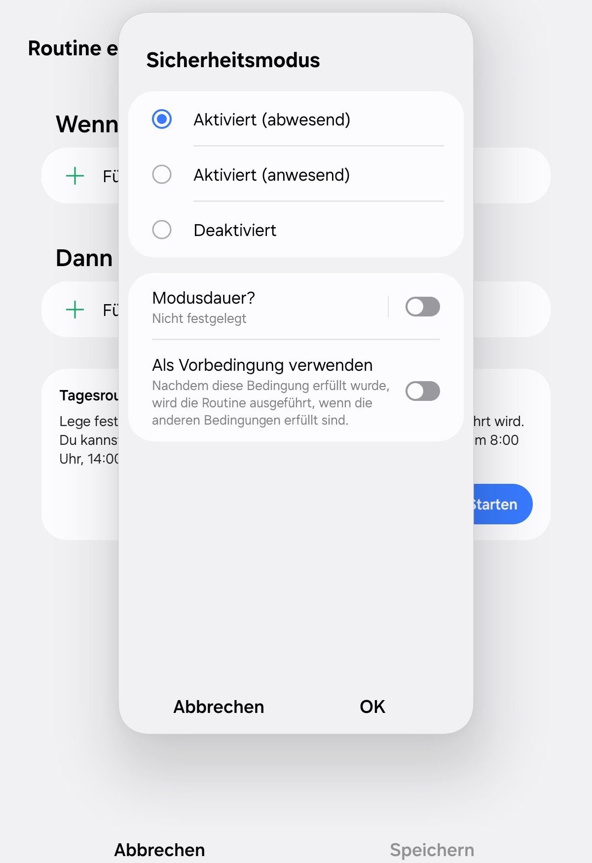

That’s exactly what the security modes of the STHM are for?

Not necessarily.
It’s possible to want the house armed or disarmed with each of family, alone, hunter mode, and away.
One COULD use them that way but “Modes” makes more sense though for more granular control of devices.
