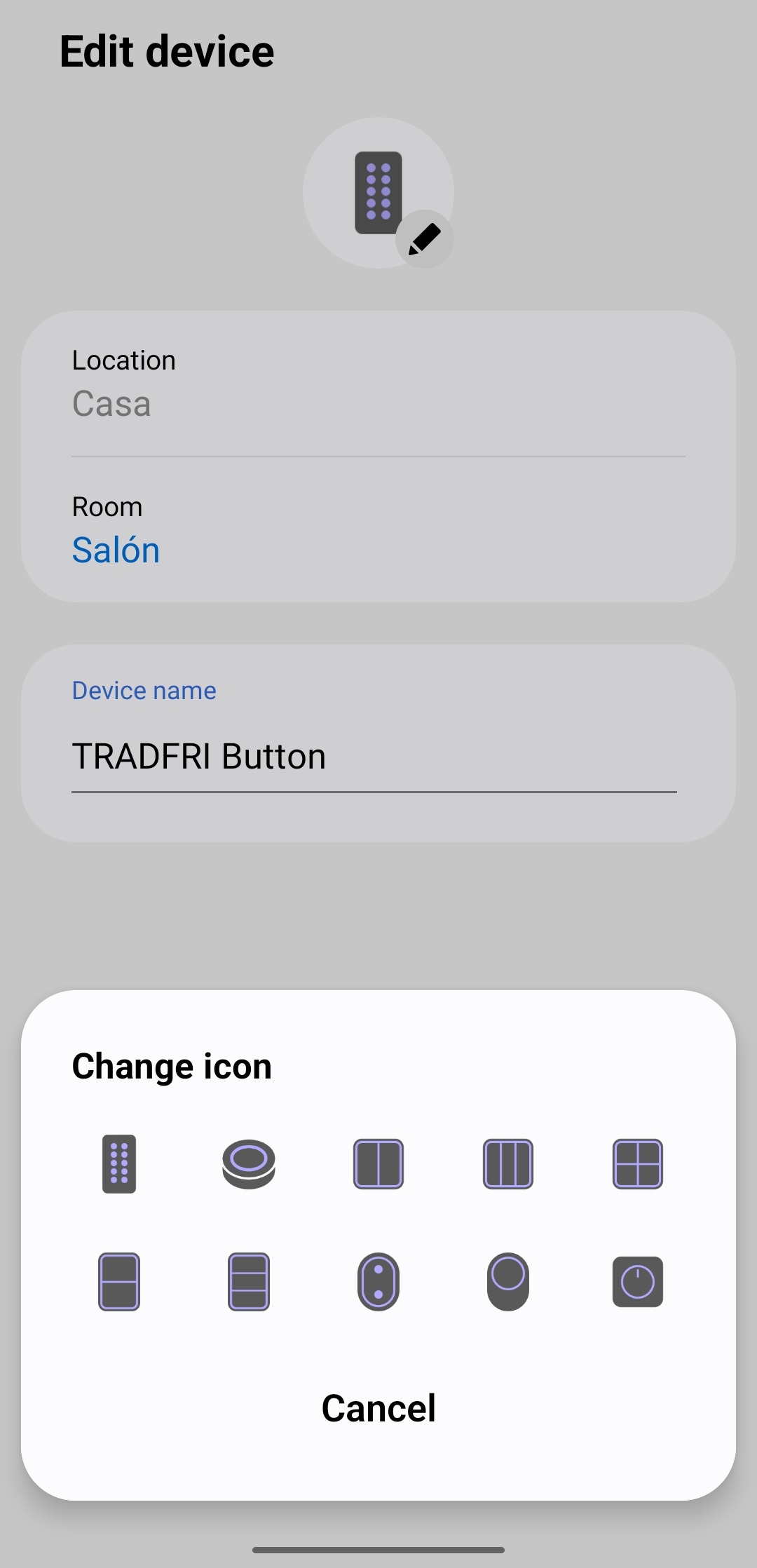

:white_check_mark: Add support to change icons
While you don’t usually interact with the button UI except to set automations, given pretty much every device type in SmartThings has different icons to choose from, why can’t button icons be changed? Would be nice to provide icons with different number of buttons and shapes instead of the boring 8-button icon that looks like a TV remote.

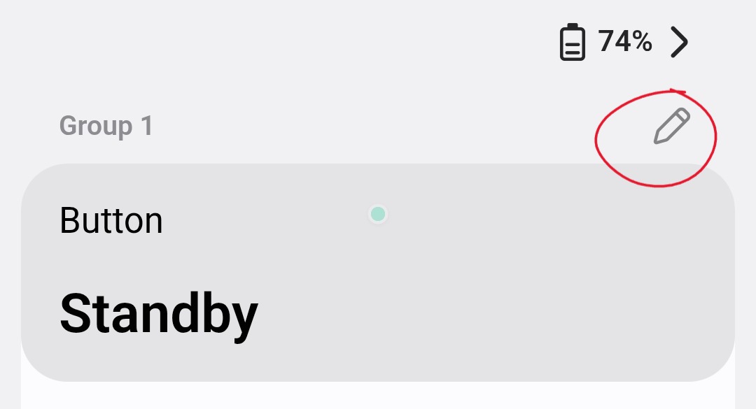

ICYMI it’s there now :smiley:
And also routines are using labels
Surprise! Don’t know when it was added since it wasn’t announced but thanks for that :grin:

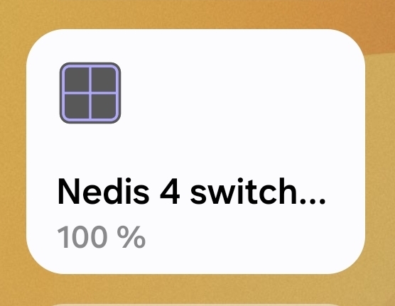

Button icons have also come here to the north.
Good addition to the App
my smartthings com also supports these icons
Hopefully the next release will feature a 4-button icon (with rounded corners).
