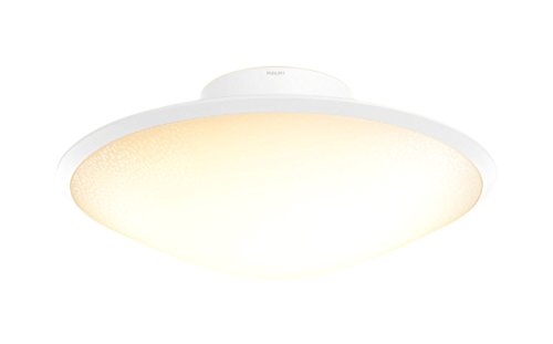

You’ve gotten a lot of good suggestions, I just wanted to mention that Phillips does make a 4 inch recessed light in their Phoenix line that works with the hue bridge. Adjustable cool white to warm white.
http://www.usa.philips.com/c-p/311553148/hue-phoenix
