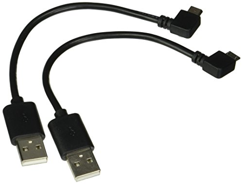

This cord looked pretty good for my needs… I think? Does it look right?
http://amzn.com/B01COTBJ2M
Make sure the orientation of the right angle is right (small side of the connected out). I got the right angle 2 pack on this page: Amazon.com.
Haven’t hooked it up yet, but I think it’ll be just long enough to reach a recessed USB outlet behind the mount. Still looking for the outlet however.
RE: the last cord and adapter posted above…
When you look at the included photos on the product page that you linked to, they are not consistent. So, there is no way of knowing whether this one actually turns one way or the other. Recommend = Buy only after checking with the seller or asking question on Amazon to find out which way it turns for sure, because it definitely matters. If this one is confirmed to work, it would be an ideal candidate since it has some length and exactly the plug you’d need on the outlet end.
With this one, all of the photos on the product page show it turning the correct way for what we need for this mount.
The only drawback to this one is that it’s an adapter and not really a cable. The good thing is that the ‘other’ end is simply a ‘regular’ male USB plug. So, you just need a USB extension cable to make it to wherever your power source is.
I think it should reach the usb port in the outlet that’s sitting right behind the mount. Will let you know if that works once I’ve installed one.

I couldn’t remember exactly which cables and/or adapters have been posted. So, sorry if this is already here somewhere…
While buying something else for another project, I noticed this on Amazon and bought it…
It comes with two versions; one angled one way and the other the other way.
I know we only need one of them, but ya get both.
It says it’s for Chromecast; which makes sense.
The power source end is male instead of female. So, when using it with this 3D printed mount, unless your power source with USB outlets is immediately inside the hole you cut in the wall, you will need a ‘regular’ USB extension cable to get to the power source.
It’s an Amazon add-on item, and only costs $3.99/Prime.

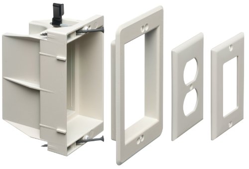

What do people have behind them? I’d like to install a recessed outlet (right now it’s just an open blue box), but haven’t found one that will really fit.
Here’s a picture of one of them in action.
This is what I have behind mine. I just went to HD to buy an outlet with USB ports, so I dont have to have the tablets charging block to deal with.
It is kinda large so the screws that hold the tablet mount to the wall do go through the frame of the outlet box.
Thanks. I looked at something similar, but the frame was large enough to show from behind the mount, so I didn’t install it.
This one is completely behind the tablet. Cannot see the box at all. I mounted it and the tablet horizontal. If I wasnt at work, Id upload a pic of the install.
