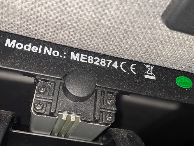

Looking at a remote control TV lift within a bed. There isn’t much data on it and I can’t find a brand name for the lift or any real info on the remote. Only wording I have is ksh24g
OK, the remote should at least have an FCC label if it was authorized for sale in the US. Look for the FCC license on the label, which might be inside the battery compartment.
If you’re not in the US, then look for any similar label or just post a photo of whatever labels there are.

Is there any info or symbols on the remote or the lift mechanism you could photo and post here??
lots of photos :slight_smile:

However from your first pic, I can confirm its going to be an infra-red (ir) remote as the led protruding from the front is an ir led.
The ksg24g is just a model number and nothing to do with the communication protocol.
As @Mikeyf79 says, it doesn’t look like an RF remote of any Kind, but rather IR (infrared, not Radio frequency). That makes it much simpler. There are lots of universal RF devices, including, btw, the Switchbot mini hub, which already has a SmartThings integration in the new V3 app.

no labels under the batteries sadly.
its definitely not IR as those are just lights that come on and there is no IR receiver on the bed itself. and i’ve already tried to teach it to my switchbot hub.
oh and the bed can be activated from a completely different room
