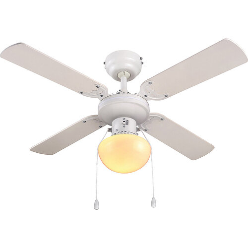

Looking at what’s available at B&Q as a sample, most of their ceiling fans also have DC motors or an integrated remote. This monster was the only one I saw that looked likely (based on what’s in store, since my experience with our hardware stores is that the stuff you can order for delivery is largely junk, and they tend to keep the good stuff on the shelf). Even then, wiring in the control module is likely a bit more complicated than here, since your fans all seem to be supplied with these lovely wire pigtails that make them easier to install but less obvious to know if the fan and light wiring is separable inside.
If you find a prettier equivalent to this, and color changing is on your list, my approach would be to figure out where to separate the wiring for the fan and light; install a fan control module in the fan wiring and keep the light hardwired to always on; and install a zigbee bulb(s) in the socket that will give you direct control on the color and dimming.
