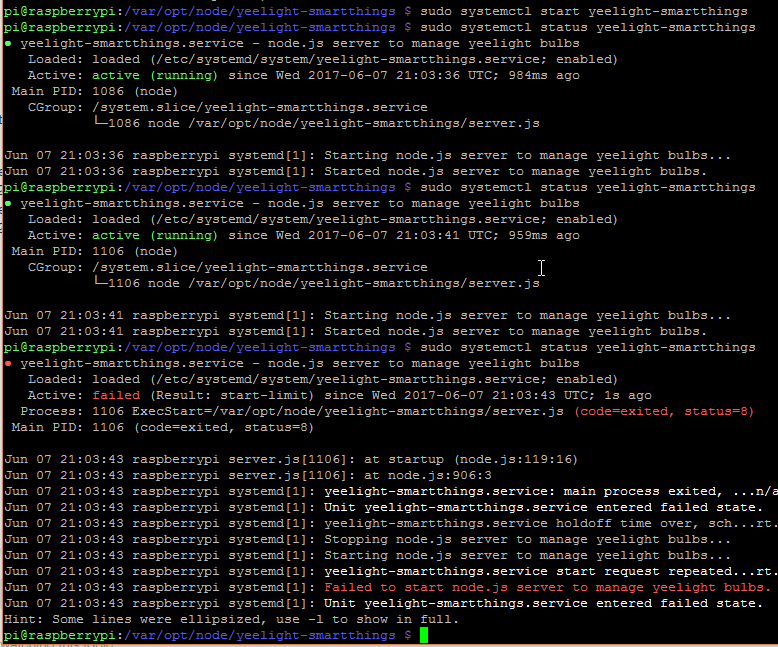

So I’m starting the server and check status and it looks like it’s active but then checking the status again then shows that it has stopped - any ideas:
All other steps to this point have gone smoothly…
Could you see if there are more useful messages in syslog?
Not sure if this helps at all…

Ah yes…ok its a node.js version thing I think
can you type node -v and let me know the result

The version after entering node -v is v0.10.29
