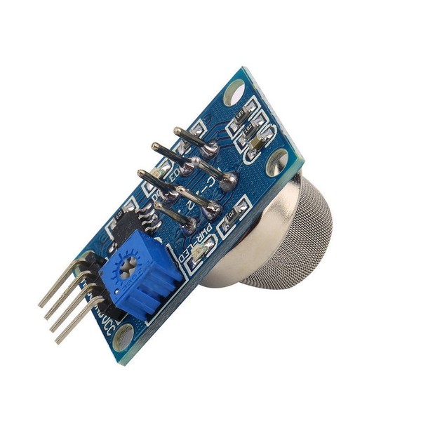

Gas Sensor ~$2:

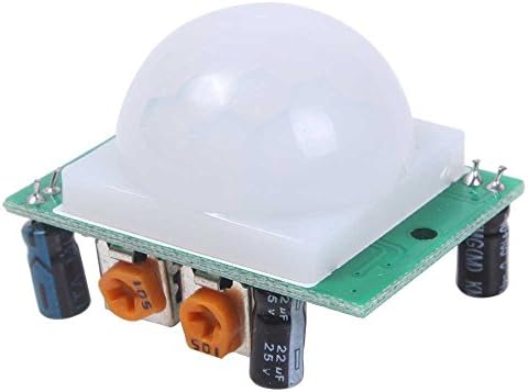

PIR motion sensors 5 for $5:
