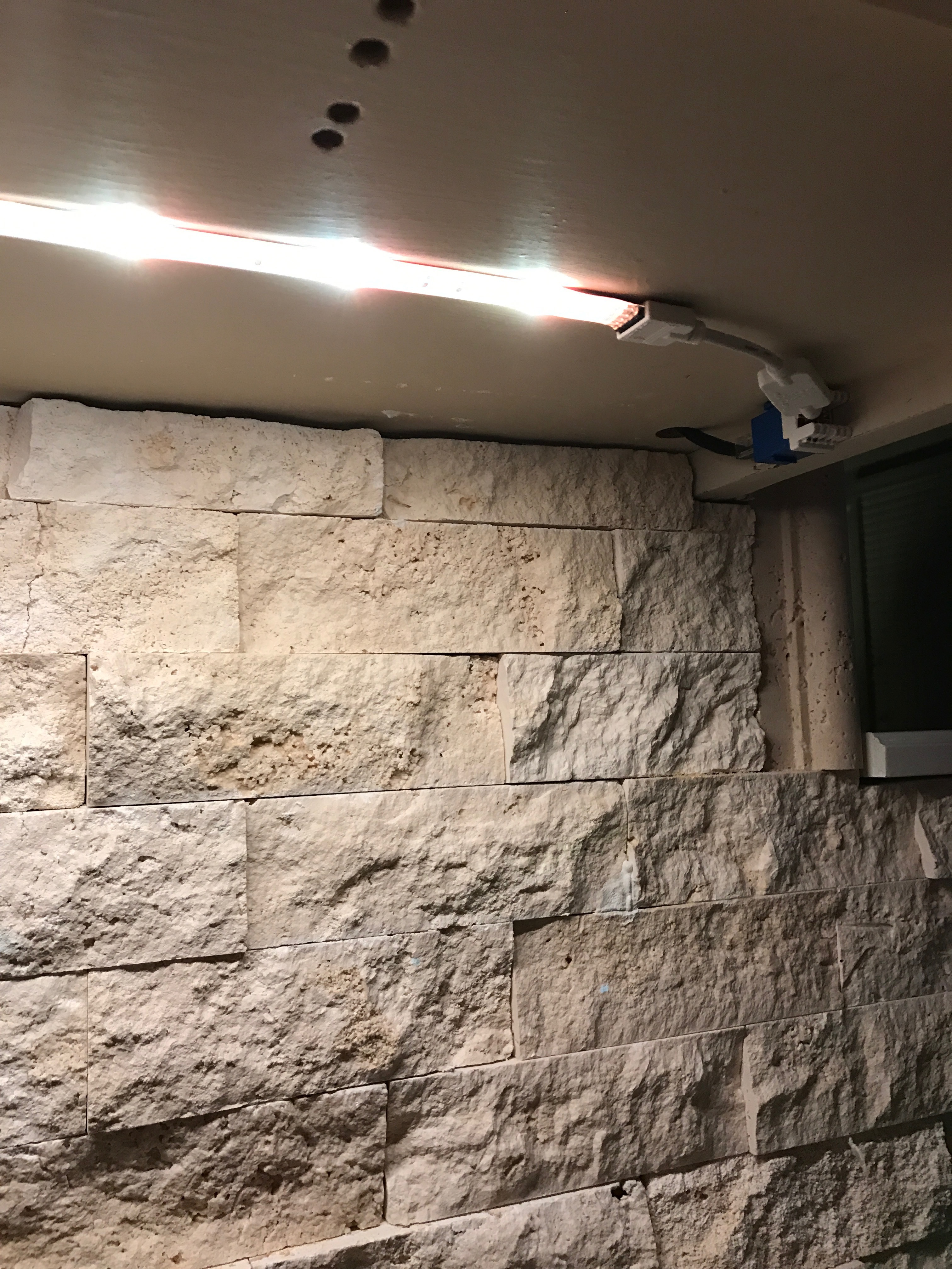

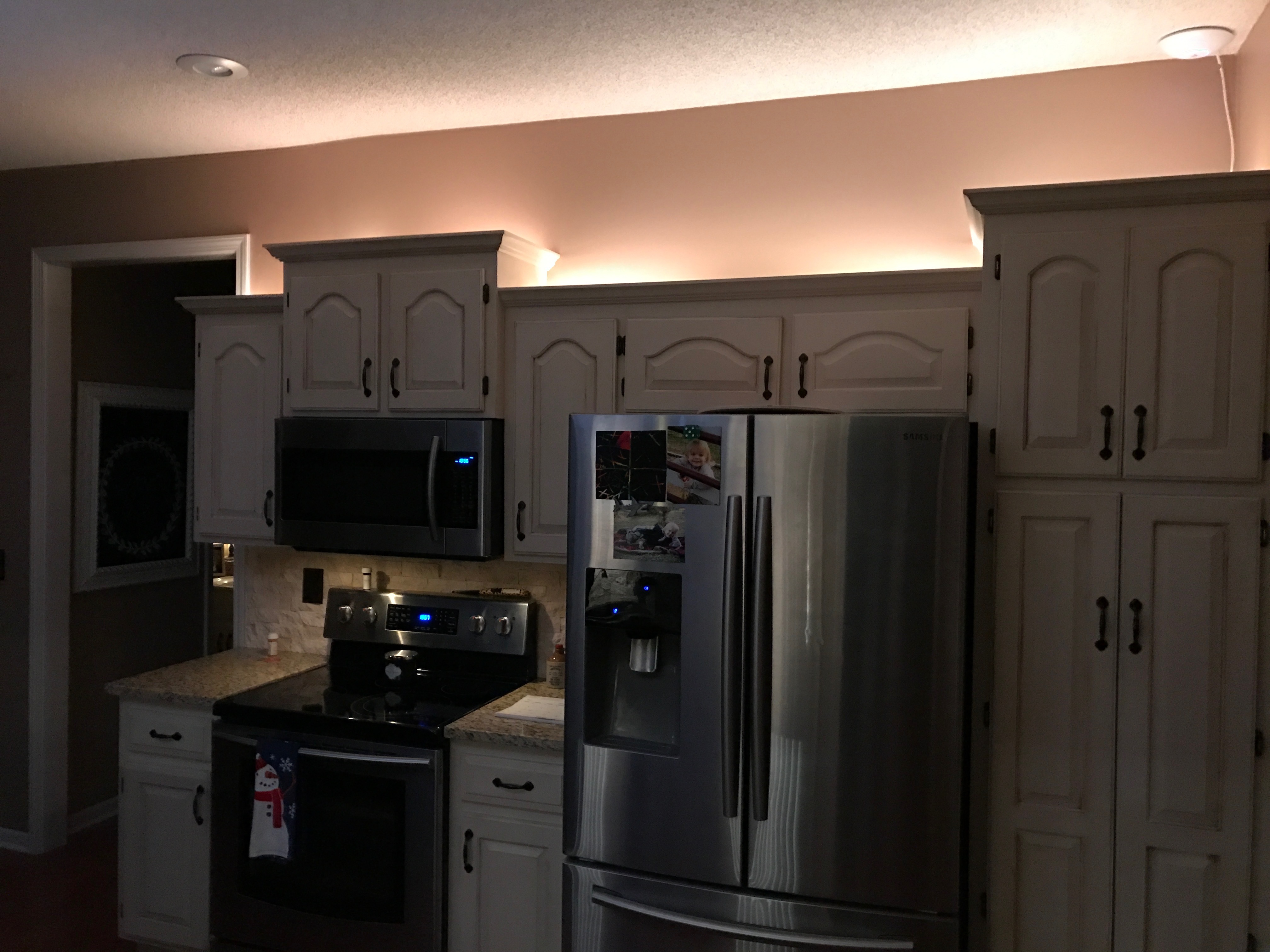

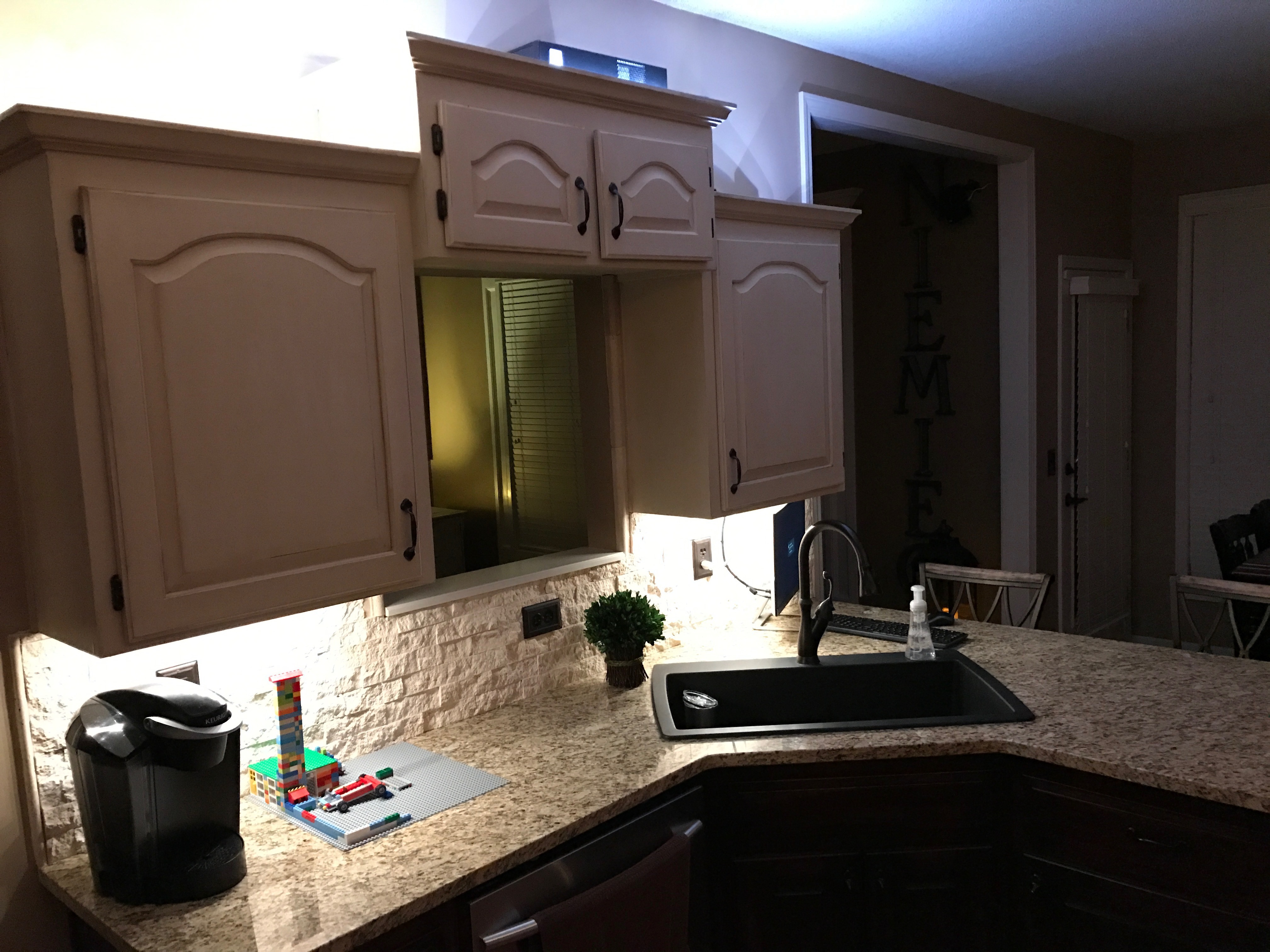

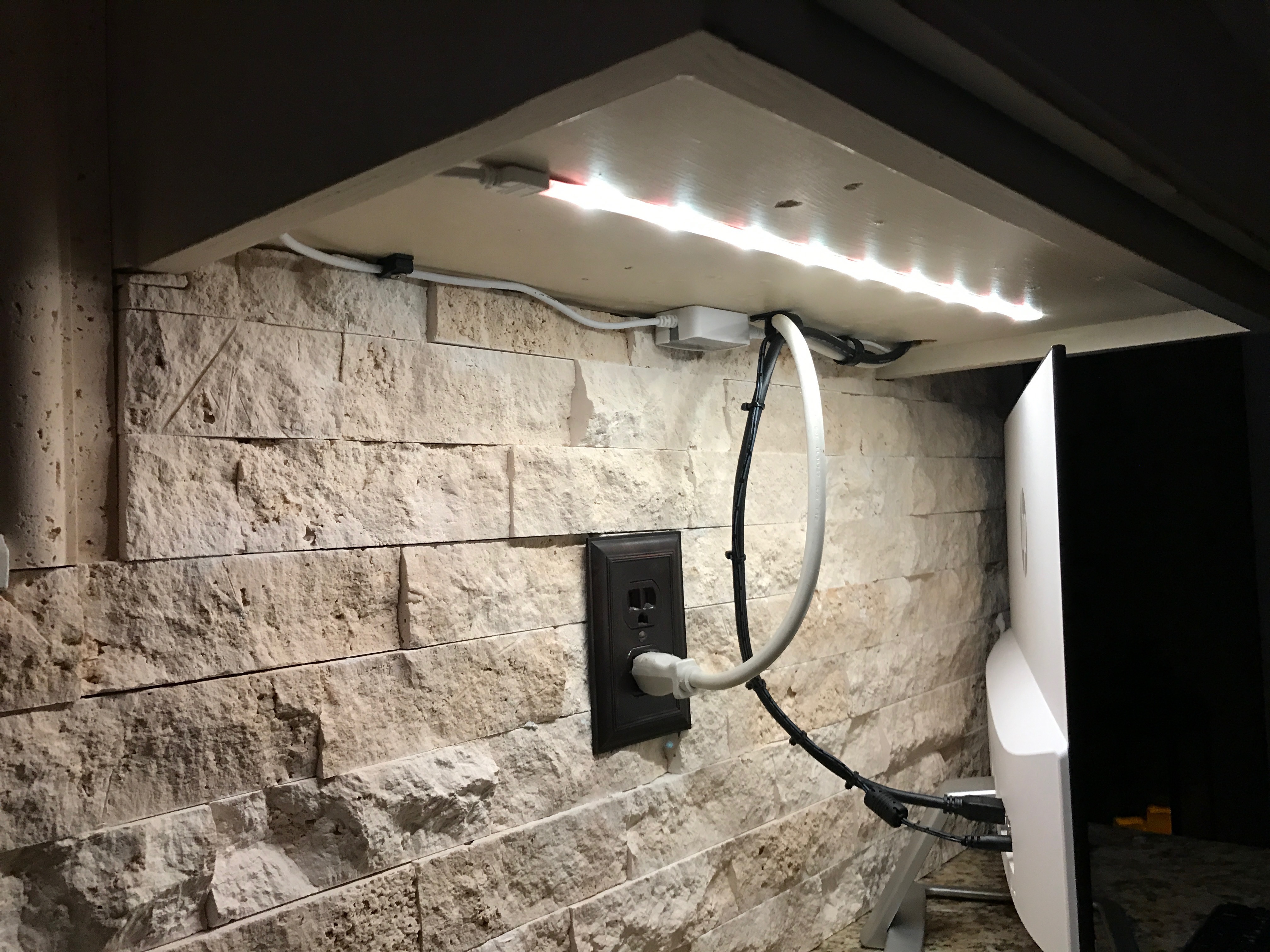

The extensions were back ordered everywhere I looked and I really wanted to finish the project out in time for a couple holiday parties at the house. So I bought one Indoor/Outdoor strip to span the top of the cabinets on other side of the kitchen, the Lightify Hub (to handle firmware updates), and one regular lightify indoor strip set. They come in 2 foot sections with short connectors to expand or connect the segments together. So I cut each connector in half, and used cat6 cable to essentially make the connector longer, allowing me to span the gap over the sink, and use a single kit to light up each section without lighting up the inside of the cabinets where the cable travels from top to bottom and across. I think it worked out pretty well. No soldering, and I didnāt have to buy connectors or additional light strip sets.

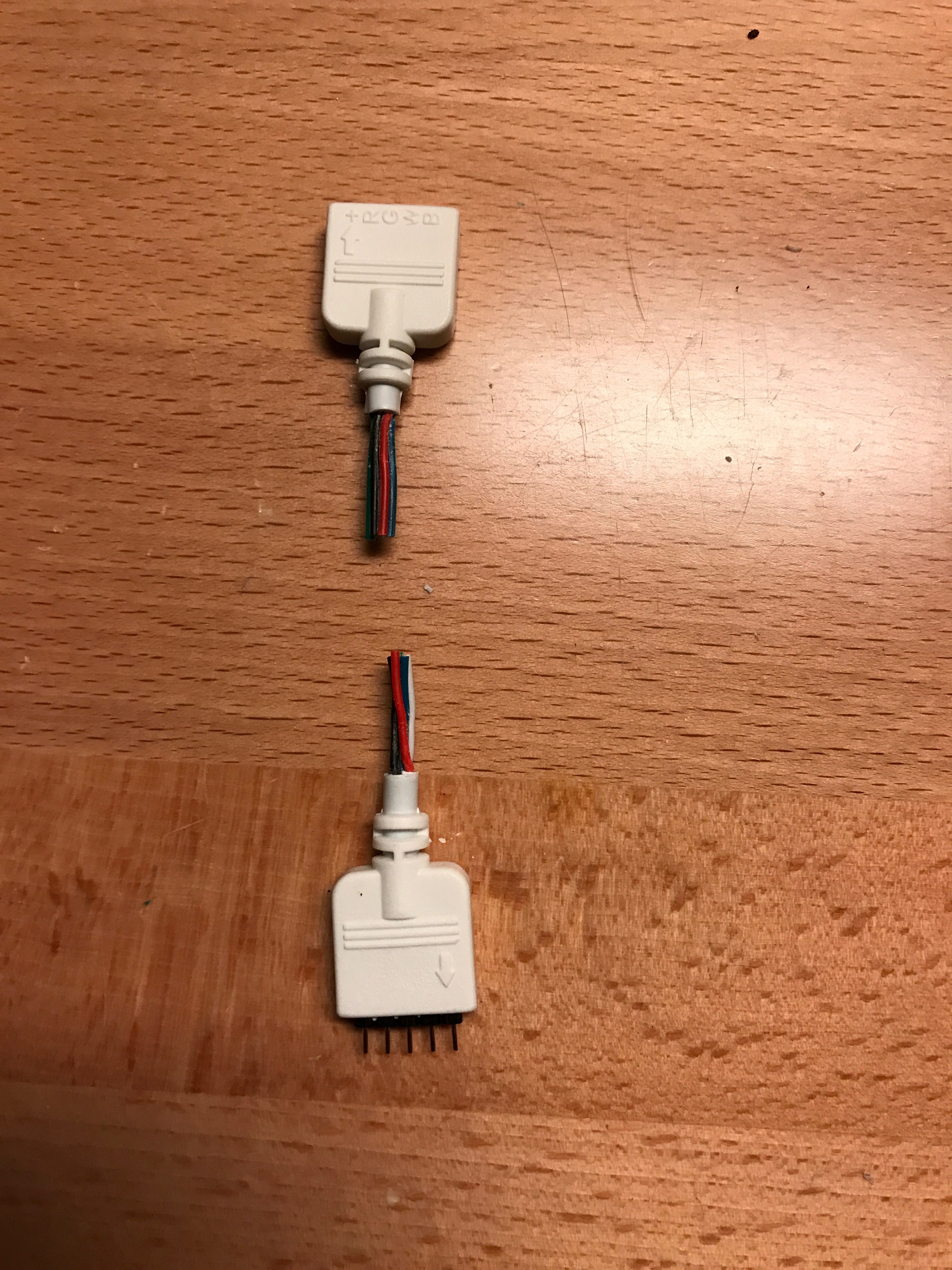

Hi, so I basically just bought the Osram Lightify indoor strip set, which came with short connectors, to allow you to string together multiple sets of strips. They look like this
I just cut them in half, and extended the wires using cat5 and keystone jacks. The lightify connectors use 5 small wires. So, I only needed to use 5 of the 8 wires that are in cat5 cables. You can pick any 5, just make sure they match at both ends.
