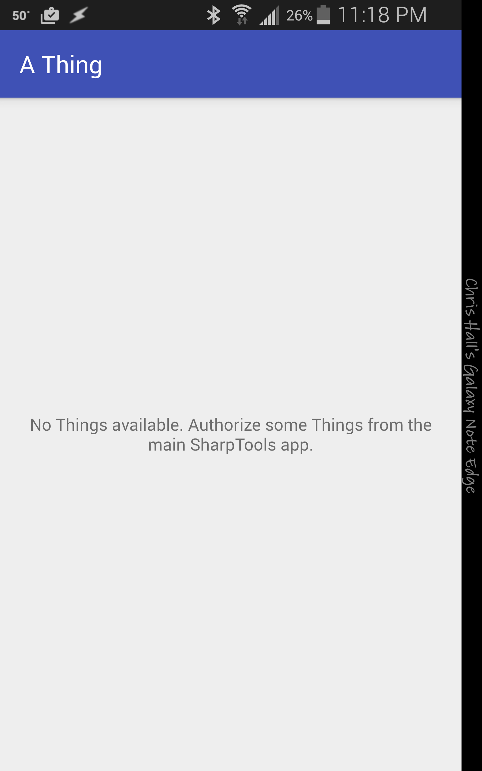

Thanks again, Joshua. Gotcha – but then on Instruction line #14, there is no " ‘tag’ icon at the top of the screen." Sorry to be tedious! Thanks for your help!
@CHallMD can you send me a screenshot? When you are in the SharpTools > A Thing configuration screen (within Tasker) you should see a tag icon at the top of the screen:

Yes, just a blank screen, mostly. No Tag. No Menu options. Hmm…
@CHallMD thanks for the screenshot! It looks like you’ll need to follow the message on the screen and authorize some of your devices/Things from the main SharpTools app. Open the main SharpTools app from your Android Launcher…then from the menu (within SharpTools), select Settings > Authorize Things and follow the prompts.

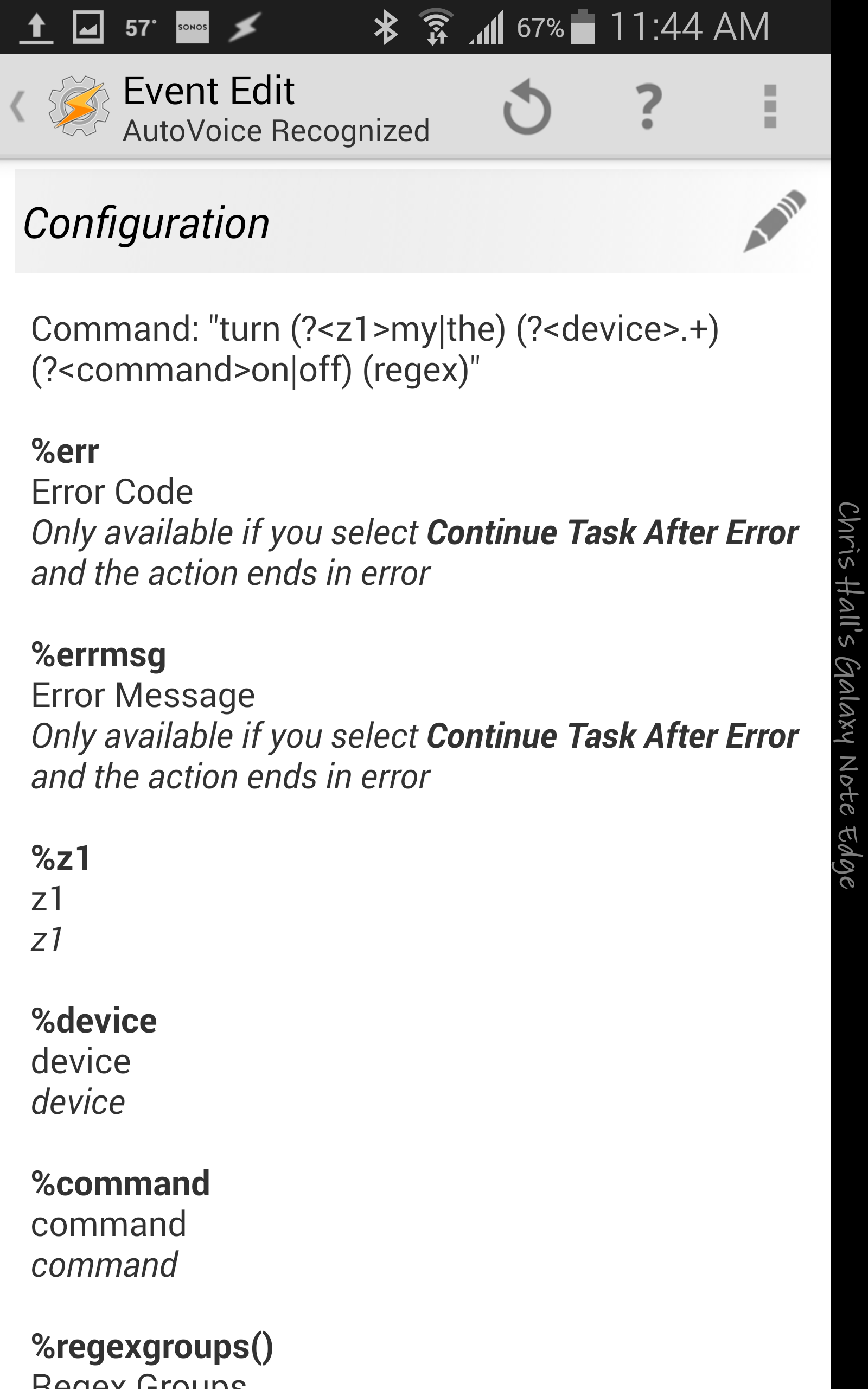

Hi Joshua – Still trying! I authorized some devices, but now this is what I get. Sorry for all these tedious messages…
Chris-
I don’t see anything immediately wrong with your screenshots, but I didn’t see any description of the problem you were having either? I put together a really quick video showing me walk through this on my Nexus 9. I go through the steps fairly quickly, so you may want to use the YouTube controls to slow the playback down or pause/rewind as necessary.
One thing to note is that you need to fully back out of Tasker before the profile becomes active - this has bitten me more than once!
