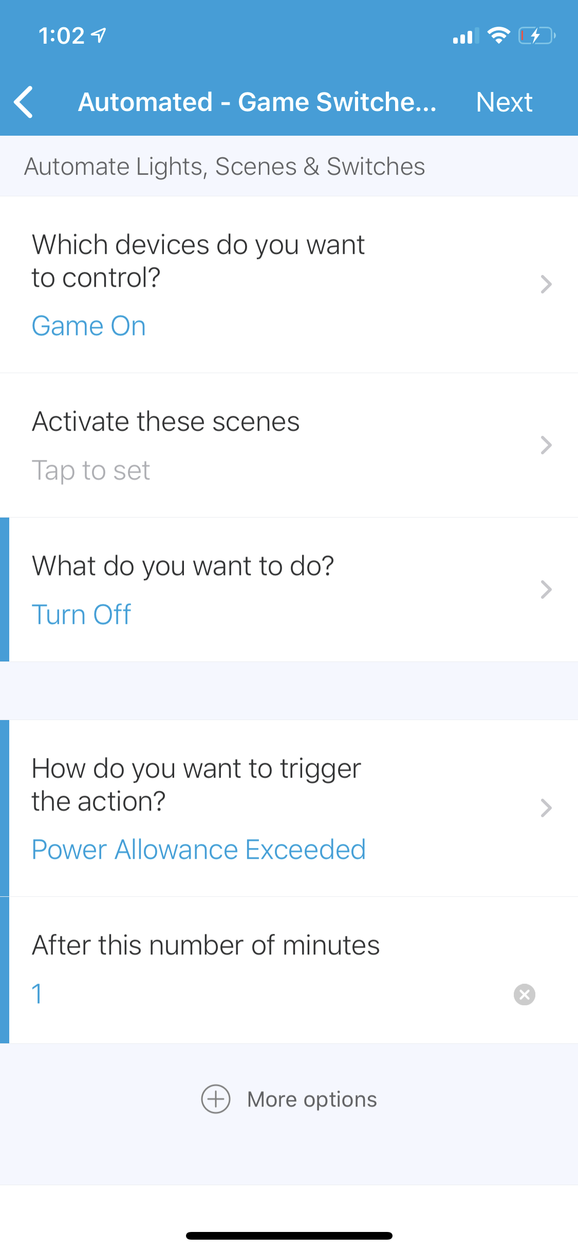

The labels aren’t very helpful, but it’s pretty straightforward.
In the new V3 app:
  1. click on the menu in the upper left corner and choose smartapps.
  1. Choose SmartLighting
  1. choose New smart lighting automation
  2. select the switch you want to turn off
  1. now comes the confusing part. There’s going to be an option that says you want to “turn on“ the switch. Pick that, and then on the next page you will be able to say that you actually want to turn off the switch.
Once you save that, it will bring you back to the previous page but now it will say ”turn off” on that same line.
  1. now you get to pick the trigger for turning off by Tapping the line that says “select trigger.“ All the way down at the bottom of the selections on the next page, there will be a choice that says “power allowance.“ That’s the one you want.
7); And after you select that option and tap “done“ you will then get to enter how many minutes you want to wait before turning the switch off. In your case it’s only going to be one.
Finish saving, and you should have an automation that will turn your virtual switch off after one minute every time you turn it on. :sunglasses:
That’s an amazing help, you made it easy to find :), but for some reason it still not working.
I’m probably doing something wrong some where. I did turn it on waited and nothing. Still on.
Im thinking somewhere linking the virtual switch to the scene could be the problem. Im not sure
Thank you it finally worked. OMG! such a relief. What do you want to do? Turn On? NO, it has to be turn off. Changing that setting finally made it work.
