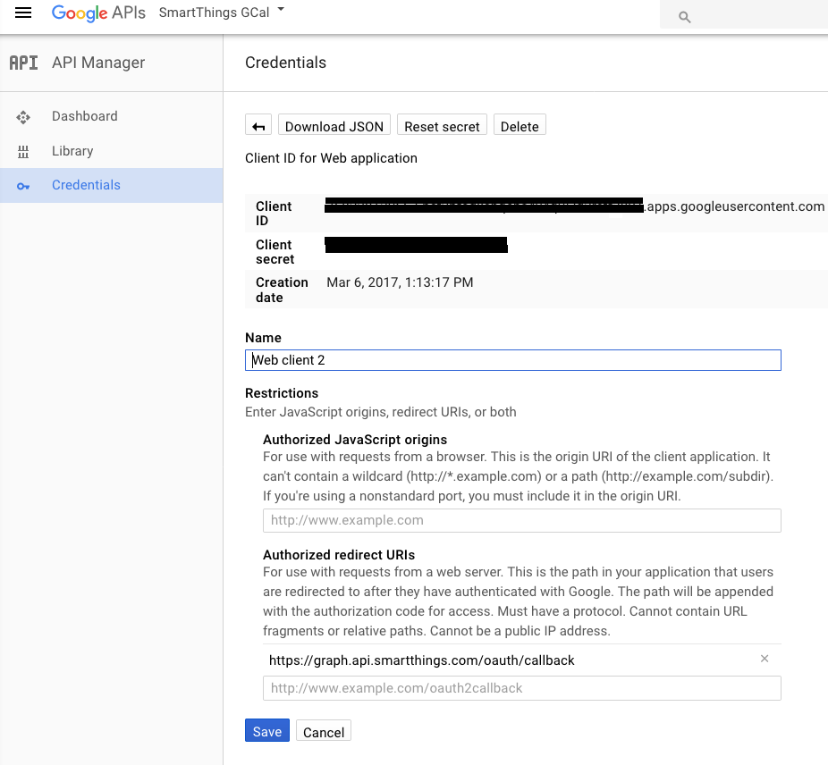

Ok. I think I see what is wrong. It looks like you didn’t set up the right type of credentials. You need the to set up Credentials for a web application. Click “Create Credentials” --> OAuth Client ID --> Web Application --> Fill in the name & redirect url --> Create
If you click on the credentials you created, it should look like this:
My screen appears exactly as yours. I tried shard1 and shard2 oath callbacks and I get the same exact message.
