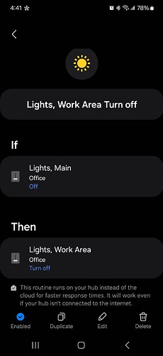

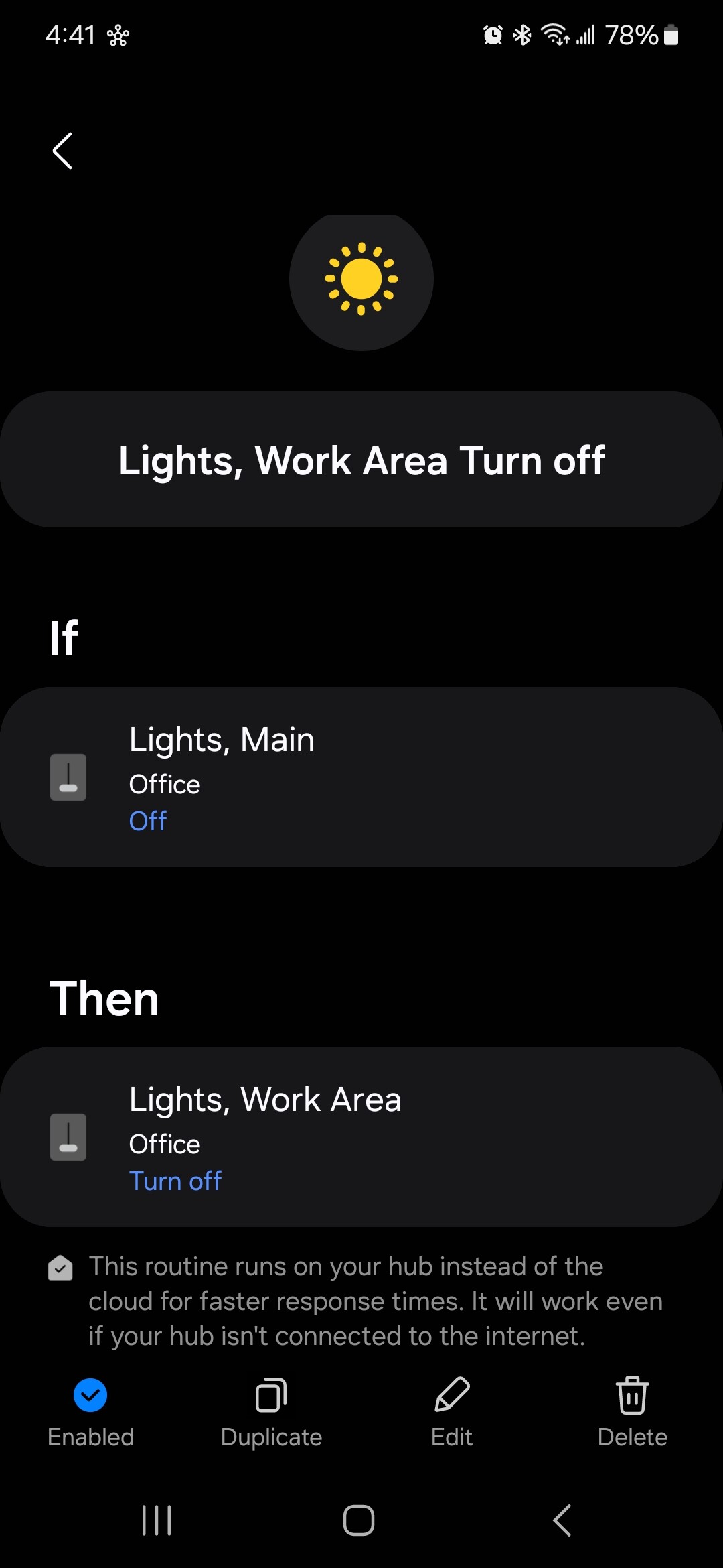

Ok, both devices show up as zwave switches. Here is what my automation looks like. But for some reason, it doesn’t work.
What is the brand and model of the two lights? And do both work when you turn them on and off from the device tile in the SmartThings app?

The biggest issue I see with this is that it’s not a trigger. I need an automation that says, “if state changes to off”. Otherwise this automation occasionally recognizes that the main light is off, and then turns off my work area light.
That’s why I initially said it would work if you always want B to be off when A is off, so that they are fully synchronized. Once you set up a rule like the one I posted above then, yes, you can no longer use switch B independently. That’s a whole different kind of rule. And it’s not a simple case on any home automation platform. I should have been clearer in that explanation, so I apologize for any confusion.

Is that what you meant by “But for some reason, it doesn’t work.”? Or is it not doing anything at all?

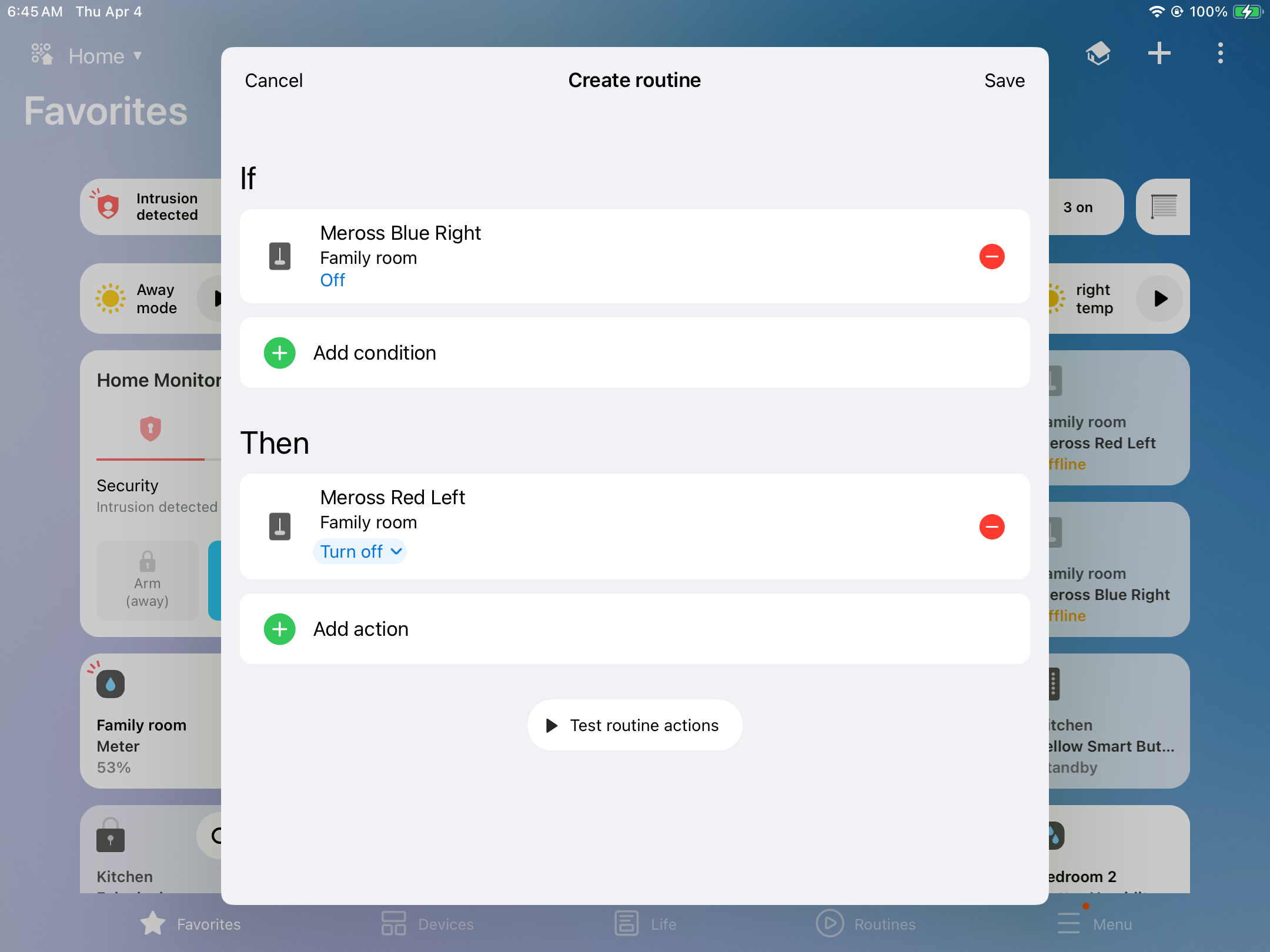

My understanding is that your Routine should attempt to turn off the Work Area Lights whenever it receives an event saying that the Main Office Lights are off. It doesn’t care what the previous event from those lights was, only that this one is off.
Any off / off sequences will, by default, get eaten by SmartThings before they make it to the Routine. For this not to be the case there would have to be a reason why consecutive off events were being generated to start with (perhaps the device being asked to report in) and then the developers of the device integration would have had to specifically override the default behaviour of SmartThings to let the event propagate regardless.
The underlying Rules that power Routines are perfectly capable of making sure the condition is only true for state changes, that just isn’t the option the Routines use.
Basically, when I press off on the main light switch near the door, I want all lights to turn off. I want this to happen even if the main light is already off just to turn off the “Work Area” lights.
Ah right, I didn’t grasp that before. You really need it to be a switch that sends out scene controls or the like when it is tapped that SmartThings can use as button presses independently of the switch/dimmer actions.
Agreed. Although I still don’t know the exact model of the OP’s switch, none of the Jasco switches of that type will tell the hub that someone pressed The off switch at the wall if the switch is already off.
