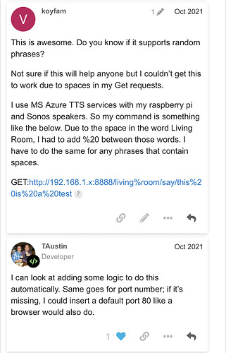

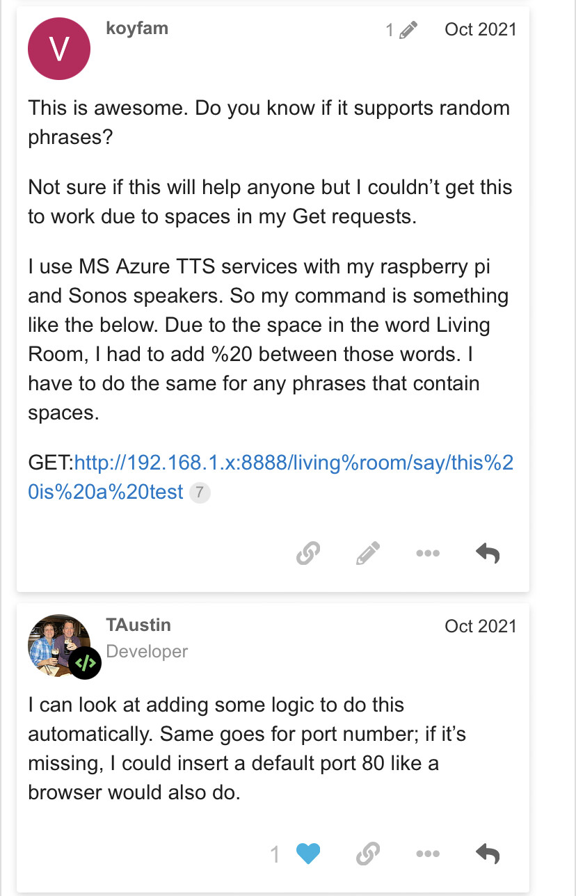

Sorry meant accounting for spaces within the body. Right now, I’m using %20 to account for spaces between a phrase so was hoping they could be automatically accounted for.
Awesome work with this driver! It’s one of my most used :slight_smile:
Is the phrase not between quotes in the body of the request? I’m surprised you would need to use %20 in the body. But maybe it is not JSON formatted?
When the driver was first released, we had touched on the space issue but I don’t recall if anything was put in place.
I can try it with quotes and see if it works.
I can understand the desire for auto-substitution in the request head string and this is something I’ve neglected and will try to include in the next update. But I thought you were saying that you were looking for this to be done in the body data as well?
That would be awesome. Sorry I was referring to the spaces in the request, not the body.
