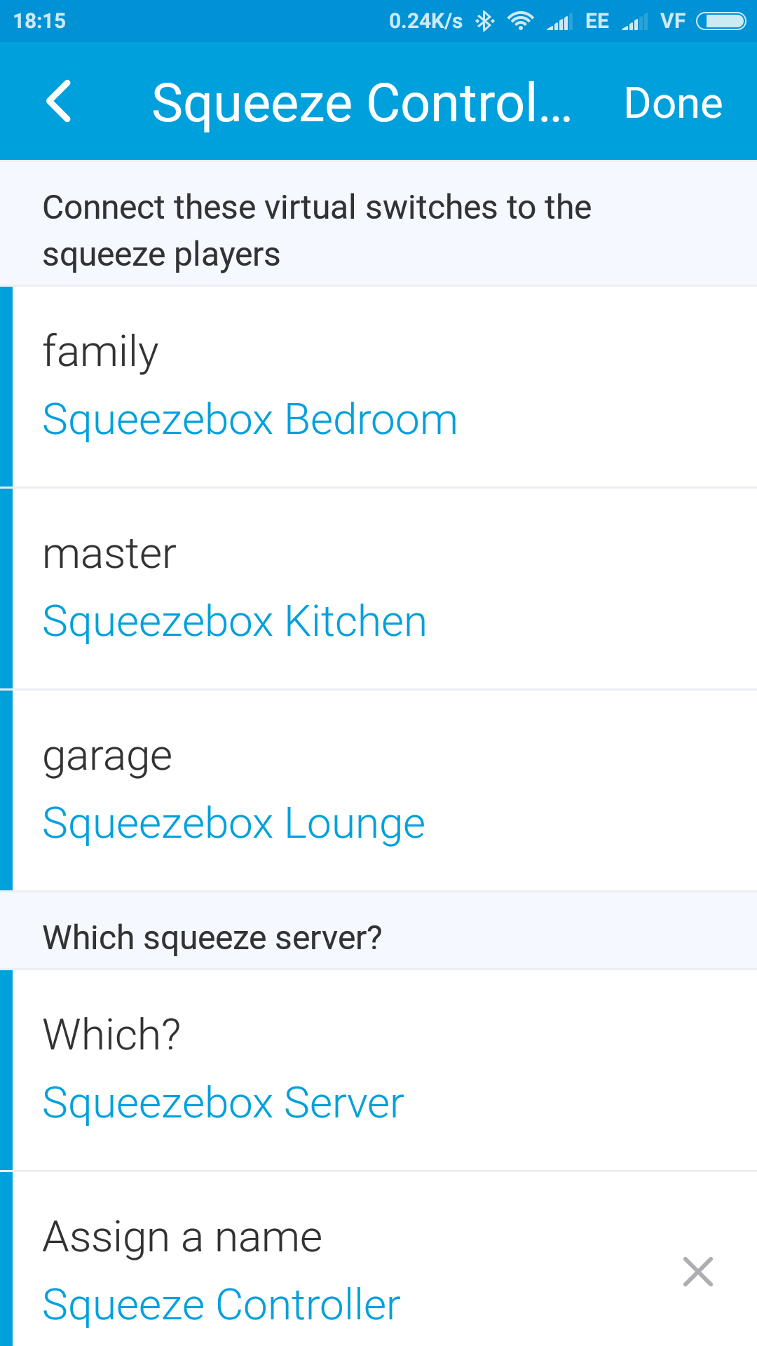

There was no metion of the Smart App in your post I assume you are using this. See Mikes post about 6 from the top. A screen shot of the settings I used for the smart App are shown below.
The selected devices are the three sqVs then the squeezeSwitch.
