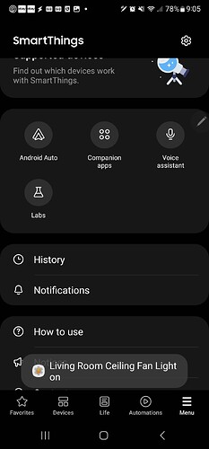

  • My Switch State will flash Device name and it’s state(on or off)
  • My Lock State will flash Device Name, State, method, codename, codeid.
Results
Switch
