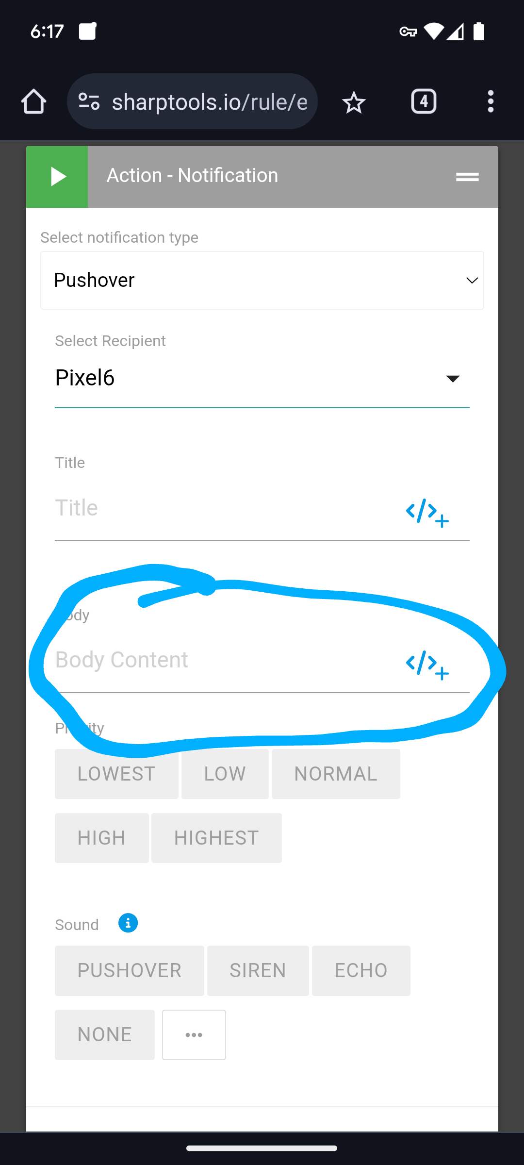

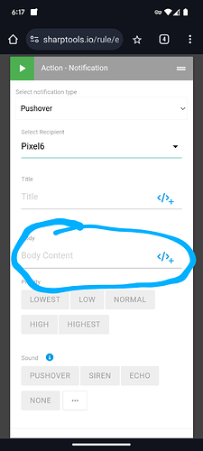

When setting up Tasker and Sharptools to update my phone as a presence sensor, what do you put in the body of the pushover for sharptools to send to Tasker?
For Title, I use SharpTools Notice. In Body, I use Wife Home (Switch On). I use my wife’s name actually, but I didn’t want to include it here. Then I use AutoNotification in Tasker to intercept the Pushover notification and Tasker turns on my wife presence switch in SmartThings, which then triggers an Automatic routine in SmartThings

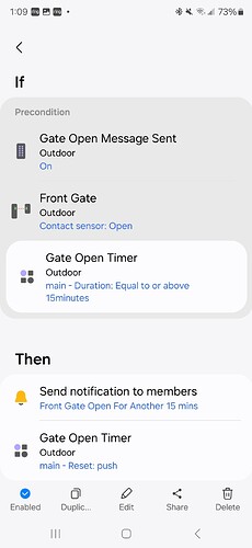

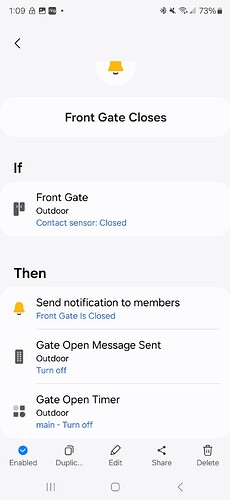

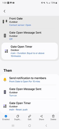

I do something similar for my doors or gate being open for an extended period. However, I use the Edge Counter Utility driver to keep track of the interval and a virtual switch to keep track of the state of the notifications. Here are my Routines:
Gate Opens
Gate Open for 15 mins
Gate Open for Another 15 mins
Gate Closes
All based on device state and no dependency on your phone.

More or less. I also use a virtual switch to indicate that the initial notification has been sent, but in thinking a little more about it, I’m not sure that’s really necessary.
Assuming, you just want to be reminded that the door is open every 30 mins, here are the Routines I’d use:
If Tilt sensor indicates door is open
  Then
Send Notification "Door is Open"
Start Door Open Timer
If Tilt sensor indicates door is open (precondition)
Timer is >=30 min
  Then
Reset Door Open Timer to Zero
If Tilt sensor indicates door is closed
  Then
Stop Door Open Timer
