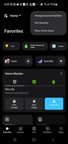

@orangebucket When I select average temperature card I get this view
with 3 dots getting me option to select devices
Also if you select 3 dots on Favorite page and show Home status, you can select individual devices for each category
Info icon explains each category
