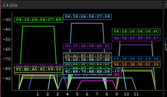

But the delay still didn’t solve the teleporting altogether. Really do think it’s interference from one or more neighbors’ Wi-Fi. There are 7 detectable WiFi networks inside my house, and I only control one of them.
Maybe, but I doubt it. I have 5 zigbee mesh’s in my house (well 4 active now that the nest is off the wall) and can detect over 30 wifi ap’s around my house (4 of which are mine).

To get technical (remember I used to do this for a living), if the signal is strong enough the channels don’t have to overlap, you can get interference on adjacent channels as well.
While channel 20 tests well against low power WiFi, it can get crushed by a high power WiFi router. One well known published study showed a 20% zigbee packet loss on channel 20 when the WiFi was switched from low power to high power.
Not saying that is what’s happening, but it fits the pattern with my problematic presence sensor better than anything else. And we looked at a lot.
