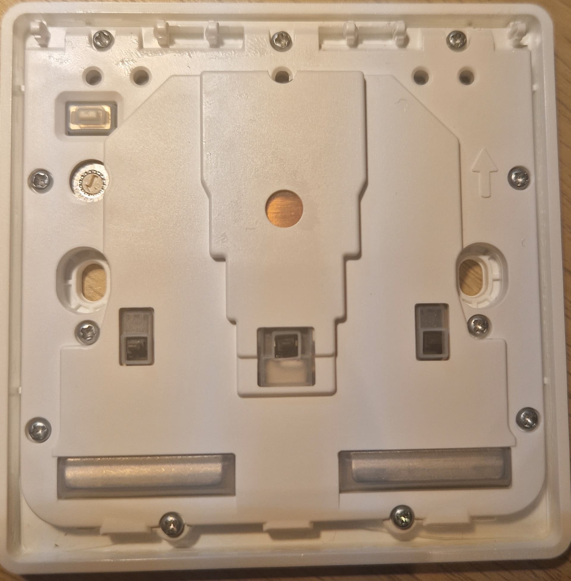

I bought Self-Powered Wireless ZigBee Switch from Aliexpress. I tried to connect it to the hub, but i didn’t manage to, even set switch to same chennel as my zigbee hub, but nothing.
Does anyone have an idea how to connect it?
It shoud at least connect as thing, right?
Self powered (no battery) Zigbee devices are using the Zigbee “green power” clusters.
Unfortunately at the present time no SmartThings hub supports this communication profile. (It is included in Zigbee 3.0 as an optional choice for hub manufacturers.) so unfortunately it will not work directly with SmartThings.
Here is a comment from a SmartThings engineer a few years ago which remains true as of this posting:
