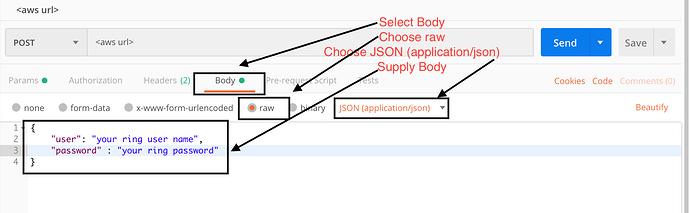

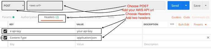

I am lost where it comes to the TEST section - can you elaborate on what I have to do there?
I also do not have a Mac so how can I get the location id and ZID???
You have couple of options here.
  1. Use a REST API testing tool like https://www.getpostman.com/
  2. Use a plugin with your chrome browser like https://chrome.google.com/webstore/detail/advanced-rest-client/hgmloofddffdnphfgcellkdfbfbjeloo?hl=en-US
For postman, you can refer below screenshots!
I tried using the chrome extension and was given the missing authentication Token message.
Wasn’t sure how to use postman either lol
Was AWS token present on the request?
For using postman, you need to install postman on your computer and open similar to any other application.
