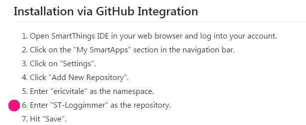

Where do you get that error. I can see in your screenshots that you have the wrong github repository.
I followed the directions and cut and paste ST-Loggimmer from line 6. I should have figured that out.

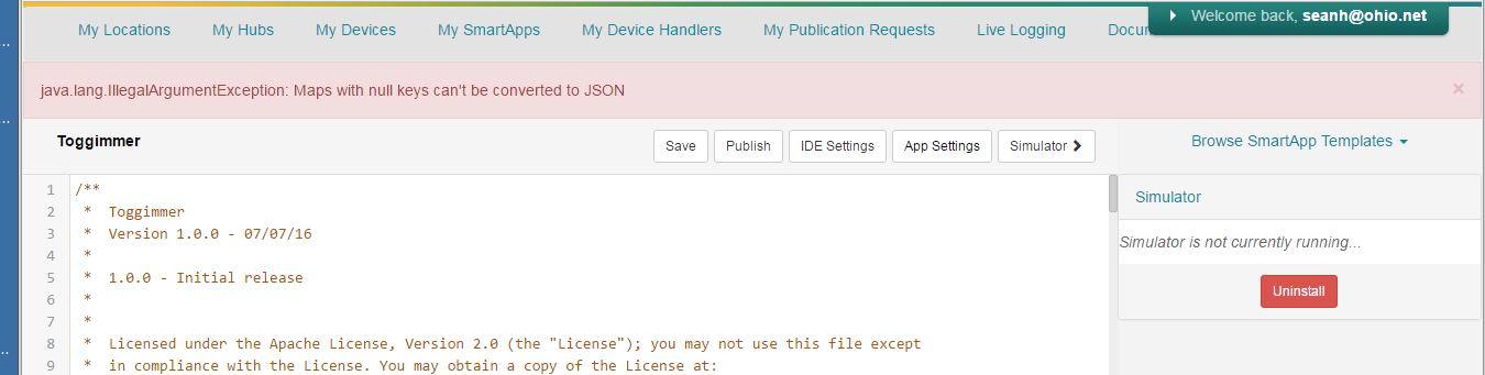

This is the error I get on the app. It does it on all the device handlers. It does it with both v2 and the standard version of the app.
There is either a bug with my code (though I can’t find one) or ST that is preventing these settings from saving on Android. Any chance you have an iOS device to use in the short term while I try to figure this out?
Yea, try iOS. You can’t trust the simulator.
I tired it on a iPhone. It shows device installed then it give the same error. After that every time I hit save I get the unexpected error banner on the app.
