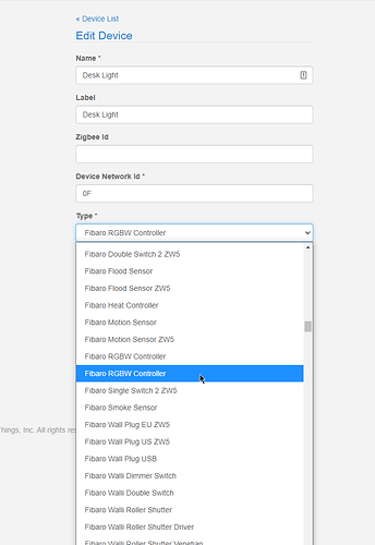

I edited the device type using IDE to the second entry called ā€œFibaro RGBW Controllerā€.

Goto Edit Device from IDE as select the following type.

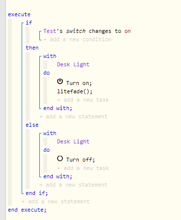

Got the special effects working. Police lights etc all working fine.
Step 1 - Set device type for Fibaro RGBW

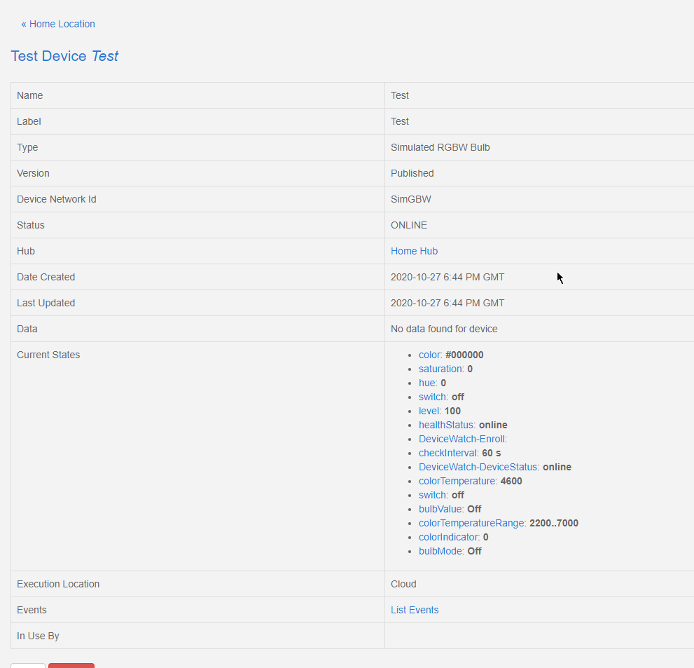

Step 2 - Create a virtual RGB
Step 3 - Configure piston.
However, you will need different switches for each one.
